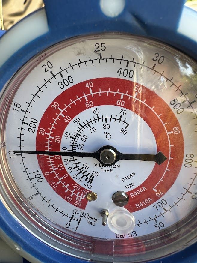

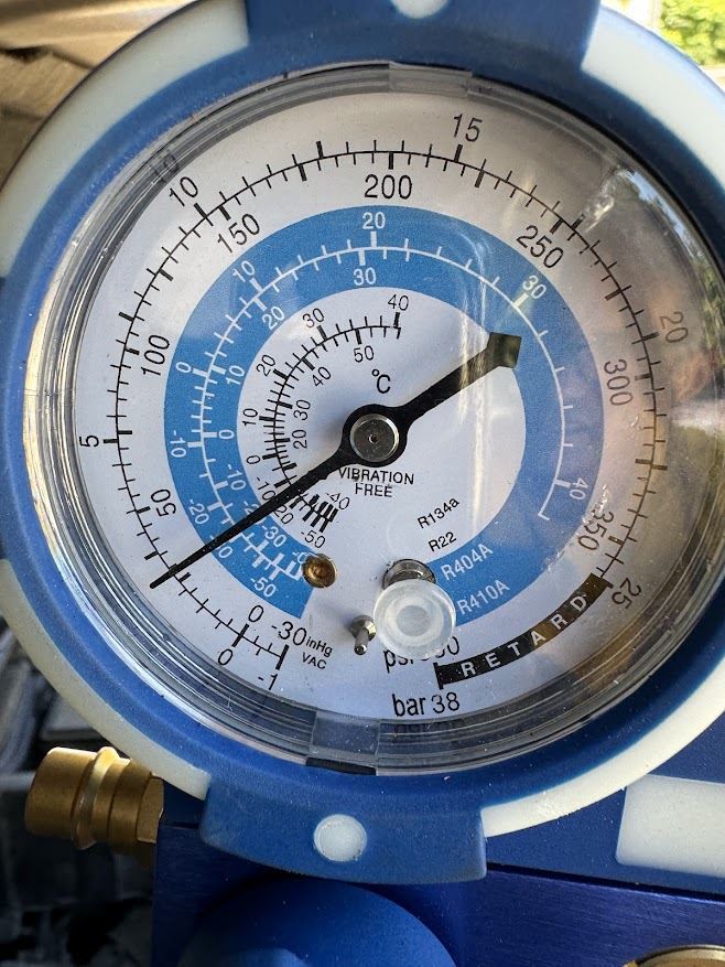

easier this way
Low side:
- Low side.jpg (123.01 KiB) Viewed 30704 times
High side:
- high side.jpg (117.03 KiB) Viewed 30704 times
Re: 2013 Honda CRV help needed
Posted: Thu Jun 27, 2024 5:23 pm
by fastsvo
