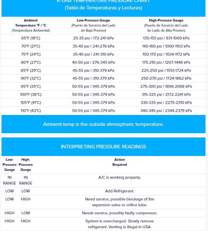

Looking at the PT Chart (attached) I found online, it seems I am just low on refrigerant. It was around 94* degrees ambient at the time.

P/T charts can often be misleading. Looking at the chart you posted, at 90°F, it says that the low side should be between 45 and 55 PSI while the high side should be between 250 to 270 PSI. At the median of 50 PSI on the low side, the evaporator will be around 50°F, hardly cold enough to provide much of any cabin cooling. And at the median of 260 PSI on the high side, the system wouldn't have effective condensing (changing the state of the refrigerant from a gas to a liquid). The result would be warm center-vent temperatures.
