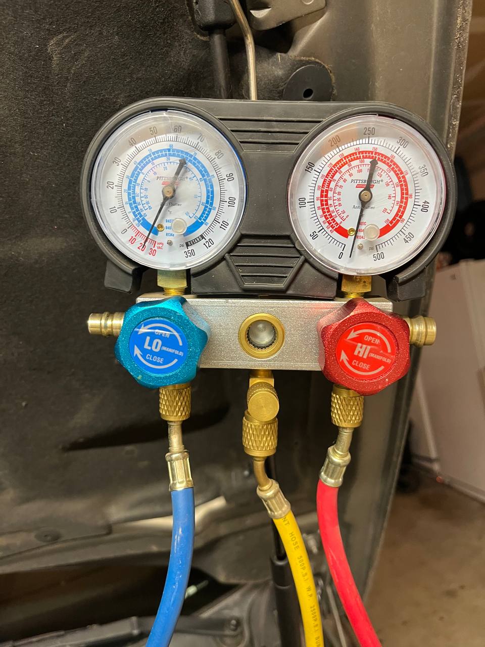

Hello - I'm trying to fix the A/C on my 04 Saab 9-5. A buddy let me borrow his Pittsburgh gauges (Harbor Freight) and using a loaner vac pump from Autozone I can only pull 22 inches of mercury on the low side gauge.

Post a pic of the couplers on the hoses.
I actually tried this earlier and the most I can pull is 22 even not connected to the car. I suppose this points to the gauges or the vac pump itself.
It's an electric pump OEM 1.8 CFM model: 57376 (VP115). Ideas on the vac pump oil? I could ask Autozone to provide me with some oil and change it.
Pics didn't come through the first time...
2023 AC Troubleshooting Gauges photo_2023-07-25_01-12-45.jpg (164.17 KiB) Viewed 18045 times

I think the problem is the loaner vacuum pump. I suggest changing the oil first and then repeating the evacuation process. From one of the photos, it appears that the oil level is low anyway. This site's sponsor, ackits.com, carries the oil you need.

Since you have no history with either item, I would try a different gauge set as well.
Perhaps the store that loaned you a vacuum pump has a gauge set you can borrow.
Usually a leak that won't pull below 22 inches is big enough to give a long evac time. Your system seems to pull right down.
