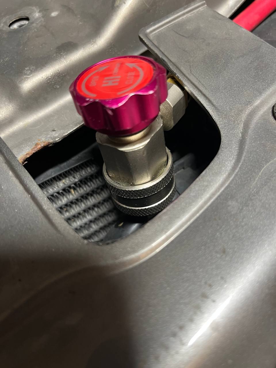

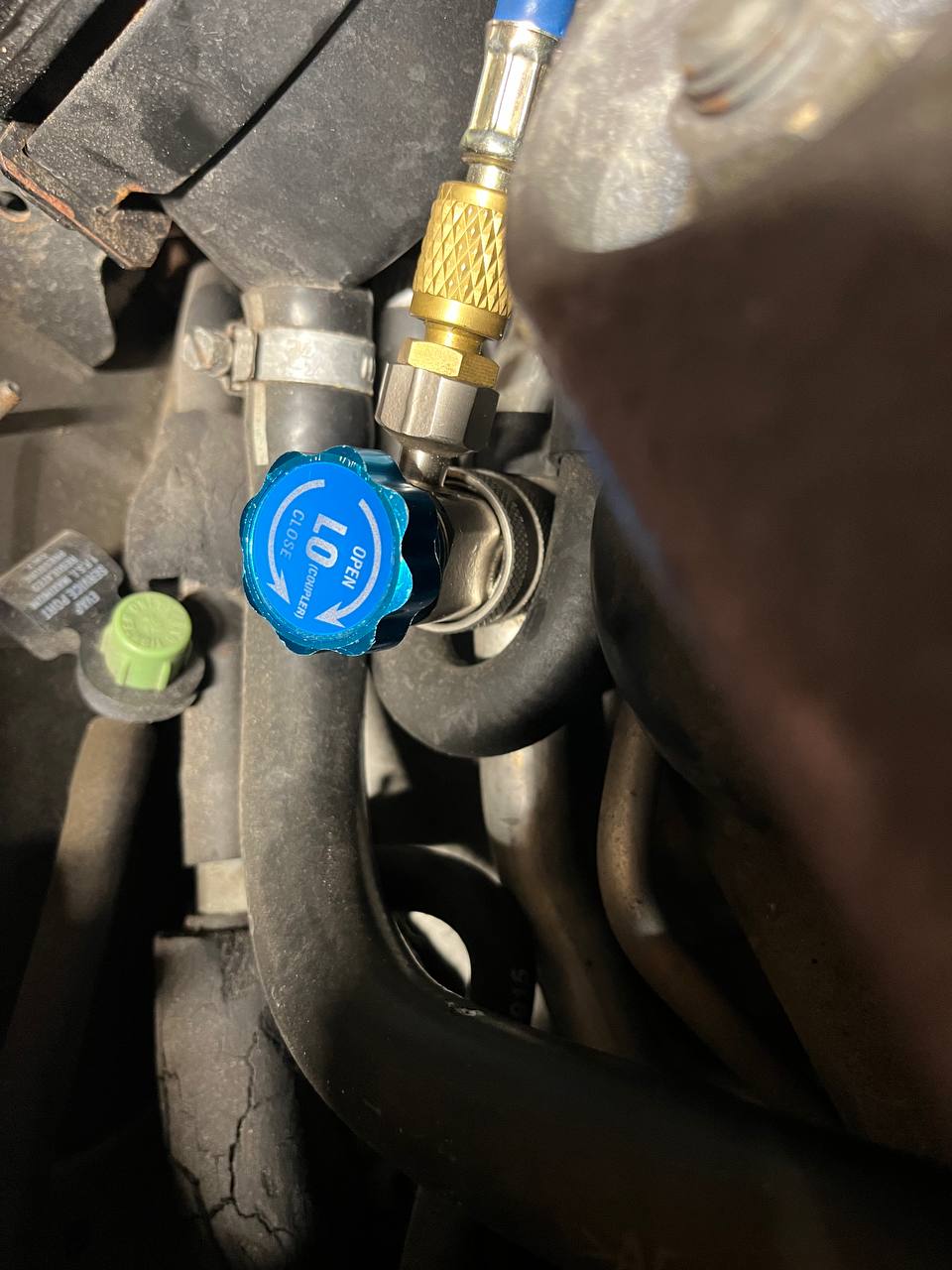

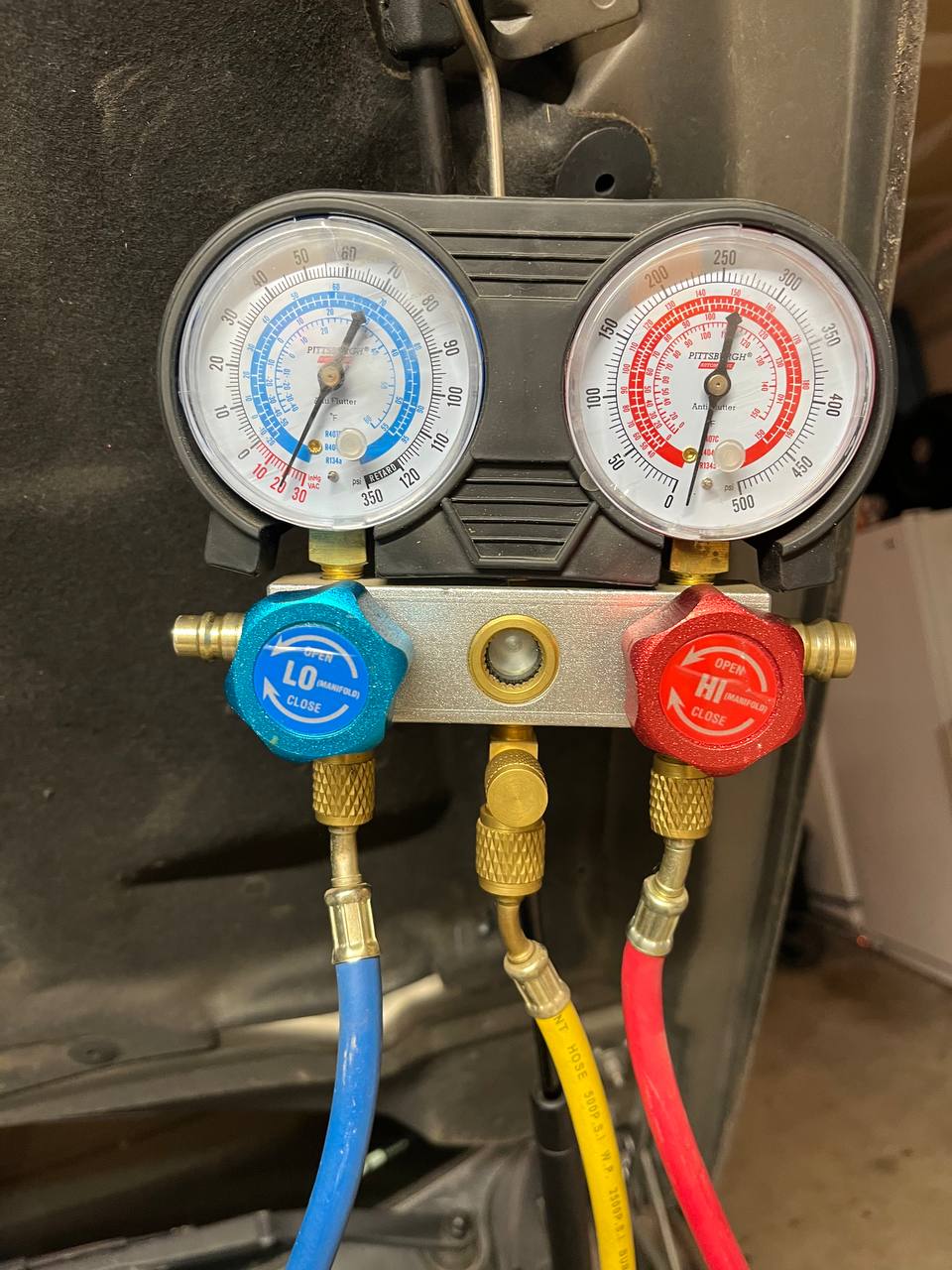

Post a pic of the couplers on the hoses.
I actually tried this earlier and the most I can pull is 22 even not connected to the car. I suppose this points to the gauges or the vac pump itself.

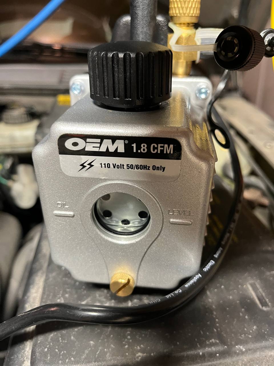

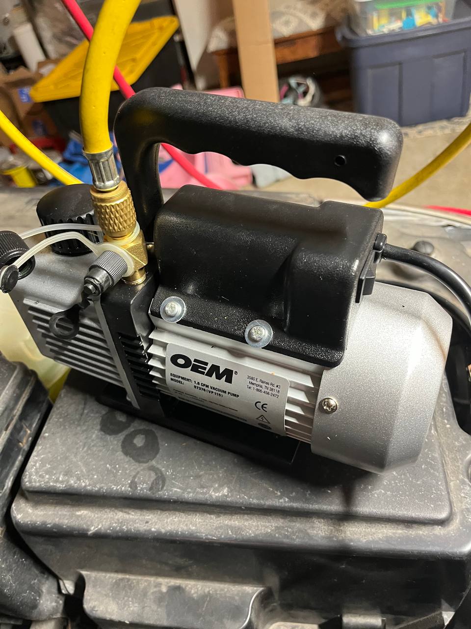

It's an electric pump OEM 1.8 CFM model: 57376 (VP115). Ideas on the vac pump oil? I could ask Autozone to provide me with some oil and change it.
2023 AC Troubleshooting High Side photo_2023-07-25_01-12-05.jpg (110.36 KiB) Viewed 17850 times
2023 AC Troubleshooting Low Side photo_2023-07-25_01-12-41.jpg (106.64 KiB) Viewed 17850 times
Pics didn't come through the first time...
2023 AC Troubleshooting Gauges photo_2023-07-25_01-12-45.jpg (164.17 KiB) Viewed 17851 times
2023 AC Troubleshooting Vac Pump 2 photo_2023-07-25_01-12-53.jpg (144.03 KiB) Viewed 17851 times
2023 AC Troubleshooting Vac Pump 1 photo_2023-07-25_01-12-49.jpg (161.61 KiB) Viewed 17851 times

I think the problem is the loaner vacuum pump. I suggest changing the oil first and then repeating the evacuation process. From one of the photos, it appears that the oil level is low anyway. This site's sponsor, ackits.com, carries the oil you need.

Since you have no history with either item, I would try a different gauge set as well.
Perhaps the store that loaned you a vacuum pump has a gauge set you can borrow.
