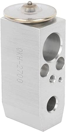

I know there is another expansion valve, it's a metal block and it looks like it might be thermostatic. I thought this was for the rear AC since the part is listed as being for vehicles with rear AC. I need to do some reading on the on the AC system for this truck before I start just replacing stuff.
Re: 2007 Yukon Denali – no air flow – freezing but not low on charge?
Posted: Sat Oct 02, 2021 9:21 pm
"I know there is another expansion valve, it's a metal block and it looks like it might be thermostatic."
It is if it looks like this
- 51F8d-g8WkL._AC_SY450_.jpg (8.43 KiB) Viewed 13920 times

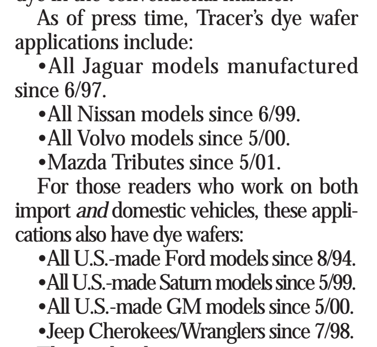

There is dye in the system so somebody was trying to find the leak at some point.
Our 2005 Yukon had UV dye in in from the factory, or maybe it was our 1994 Suburban - or both; there was a sticker under the hood stating this.
Both have been sold now, I don't know about our 2011.....
I saw a PDF stating all GM models since mid-2000 contain UV dye:
- AC UV Dye 062005_08-1 capture.png (136.64 KiB) Viewed 13787 times

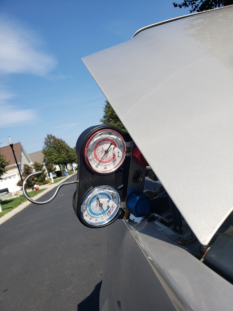

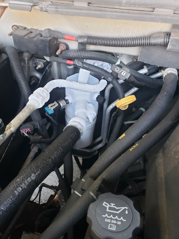

OK, here is an update. It was a beautiful day today, maybe 75 degrees. I just set the AC for full auto and 65 degrees. It was running both the front and rear AC (since that is what it does when you hit the auto button). I drove the truck for about 45 minutes. It took that long but it finally froze. I know from experience it will still freeze when you turn off the rear AC (which presumably stops refrigerant flow to the rear circuit via that metering block).
Here is a pic of the accumulator. It’s frozen of course. The smaller pipe has the orifice tube that I changed. At 1500 rpm the pressures were about 5 and 150. At idle they are still too low.
So that’s not ideal. If I let it thaw for 1-2 minutes the pressures are about 30 and 250 but rapidly drop. Perhaps it’s just low on refrigerant and I need to fix the leak first. I really have no idea of the leak rate at this point. These things tend to get worse over time. If this was a home AC system I would check superheat and subcool to try to determine if it has a full head of refrigerant going to the metering device.
- Denal-AC-1.jpg (232.24 KiB) Viewed 13952 times
