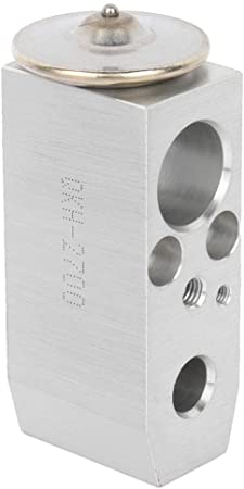

If this was a residential AC system I would make sure the air flow is OK and then take a look at the expansion valve (TXV). In the truck, I did change the orifice tube which I was assuming was the expansion valve for the front.
I know there is another expansion valve, it's a metal block and it looks like it might be thermostatic. I thought this was for the rear AC since the part is listed as being for vehicles with rear AC. I need to do some reading on the on the AC system for this truck before I start just replacing stuff.
Re: 2007 Yukon Denali – no air flow – freezing but not low on charge?
"I know there is another expansion valve, it's a metal block and it looks like it might be thermostatic."
It is if it looks like this

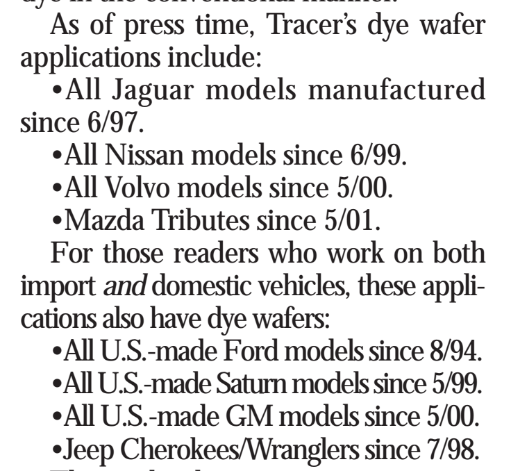

Dan-G wrote: Sat Oct 02, 2021 5:04 pm There is dye in the system so somebody was trying to find the leak at some point.
Our 2005 Yukon had UV dye in in from the factory, or maybe it was our 1994 Suburban - or both; there was a sticker under the hood stating this.
Both have been sold now, I don't know about our 2011.....
I saw a PDF stating all GM models since mid-2000 contain UV dye:
AC UV Dye 062005_08-1 capture.png (136.64 KiB) Viewed 13793 times
