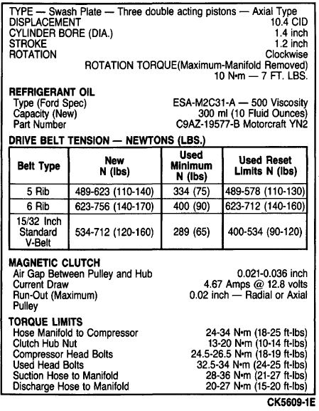

I plan to use Ester oil so if my R12 attempt fails, I can easily switch to 134a. Is there a chart somewhere that calls out oil amounts for the original R12 system?
The 1988 FS6 compressor I will use had only a few ounces of oil in it. Any oil in the rest of the components is long washed away.
Answer:Found a chart. 10 oz.

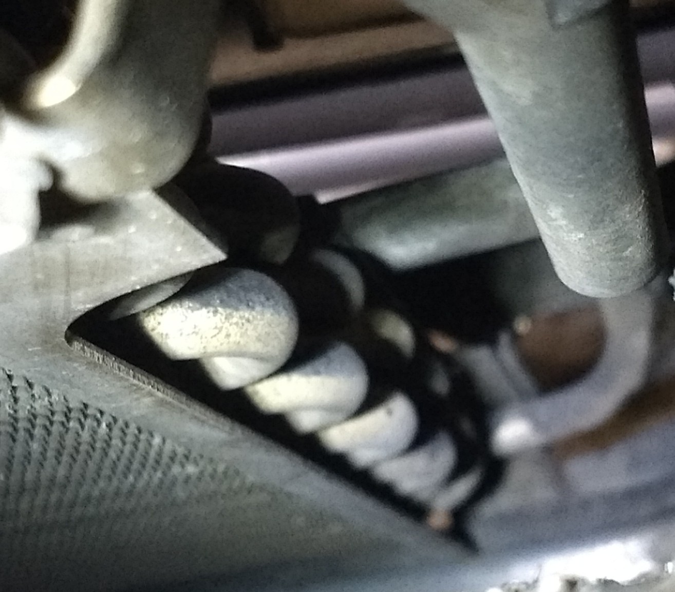

Just for the record you cannot flush a PF condenser
Re: 1986 F150 AC Restoration
I'll look at the condenser more closely. I certainly appears to be a serpentine flow. No headers on the ends, just a bunch of return bends.
An original 1986 F150 condenser will be a tube & fin unit as you have pictured. They can be flushed.
A serpentine condenser is a flat piece of extrusion with many passages side by side. It is then bent in to repeated flat rows with fins between. Effective as a condenser, but easy to clog and NOT flushable.
You can update an F150 with a more effective parallel flow unit. Ford did so in 1995. But your tube & fin will work ok if it is in good shape.

Question: Where can I find the torque value of the six long, thru bolts that hold the compressor together. They were very tight. I had to turn up the air pressure on my 1/2" drive impact to break a few loose.
Answer: The 8mm bolts on my 1988 FS-6 compressor are T40 torx socket heads with no markings. I find the hex head cap screws on my 1986 FS-6 compressor are marked 10.9. So, 8mm Class 10.9 calls for 41.3 ft/lbs. Generally, a T40 torx head bolt has a torque spec of 54-65 Nm or 40-49 ft/lbs.
EDIT: Now I'm finding a value specific the the Denso P10 (essentially the same compressor) of 27 ft/lbs. *The Ford factory service manual calls for this value with re-used bolts.

Thanks for that. My terminology was incorrect.bohica2xo wrote: Sun Jun 27, 2021 10:39 am
