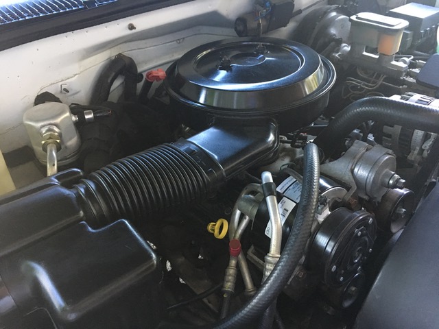

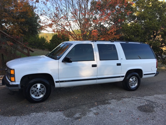

Photo of 1995 Suburban. 145k miles. I'm the second owner.

If you pull the connector off of the cycling switch, does the compressor stop?

@bohica2xo. " If you pull the connector off of the cycling switch, does the compressor stop?" Yes it does. Plug connector back in, clutch engages compressor.
Re: R4 compressor NEVER cycles
So it can cycle, you just never get enough liquid built up in the accumulator to drop the pressure.
GM used an insulator for the accumulator on some models. Part number 15-10614
Might give that a try.

When I acquired this vehicle 4 years ago, it had the original foam fitted cover on the accumulator. The a/c worked fine when I got it, except I noticed the clutch never cycled then as well. That original R4 eventually developed a leak 2 yrs later and had to be replaced. Replaced compressor, and accumulator together at the same time. That original cover had deteriorated and was not in great shape so it was not put back on. So the issue of no cycling was present for 2 yrs with accumulator cover and now without the cover. I appreciate your suggestions hopefully we can sort this issue that has dogged me for 4yrs.
