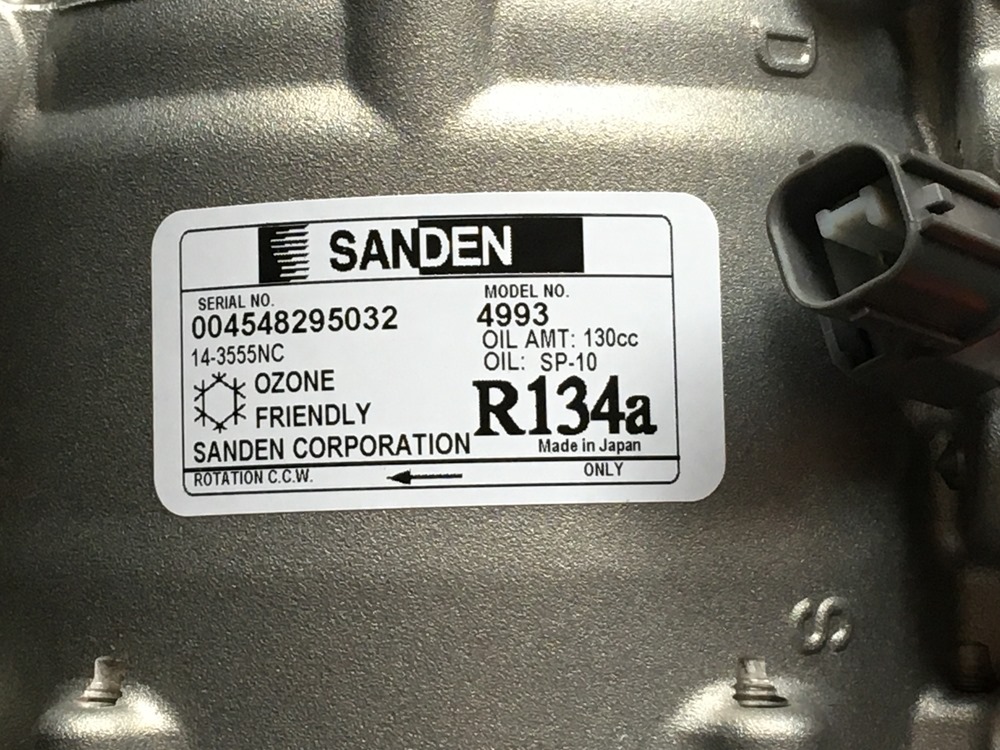

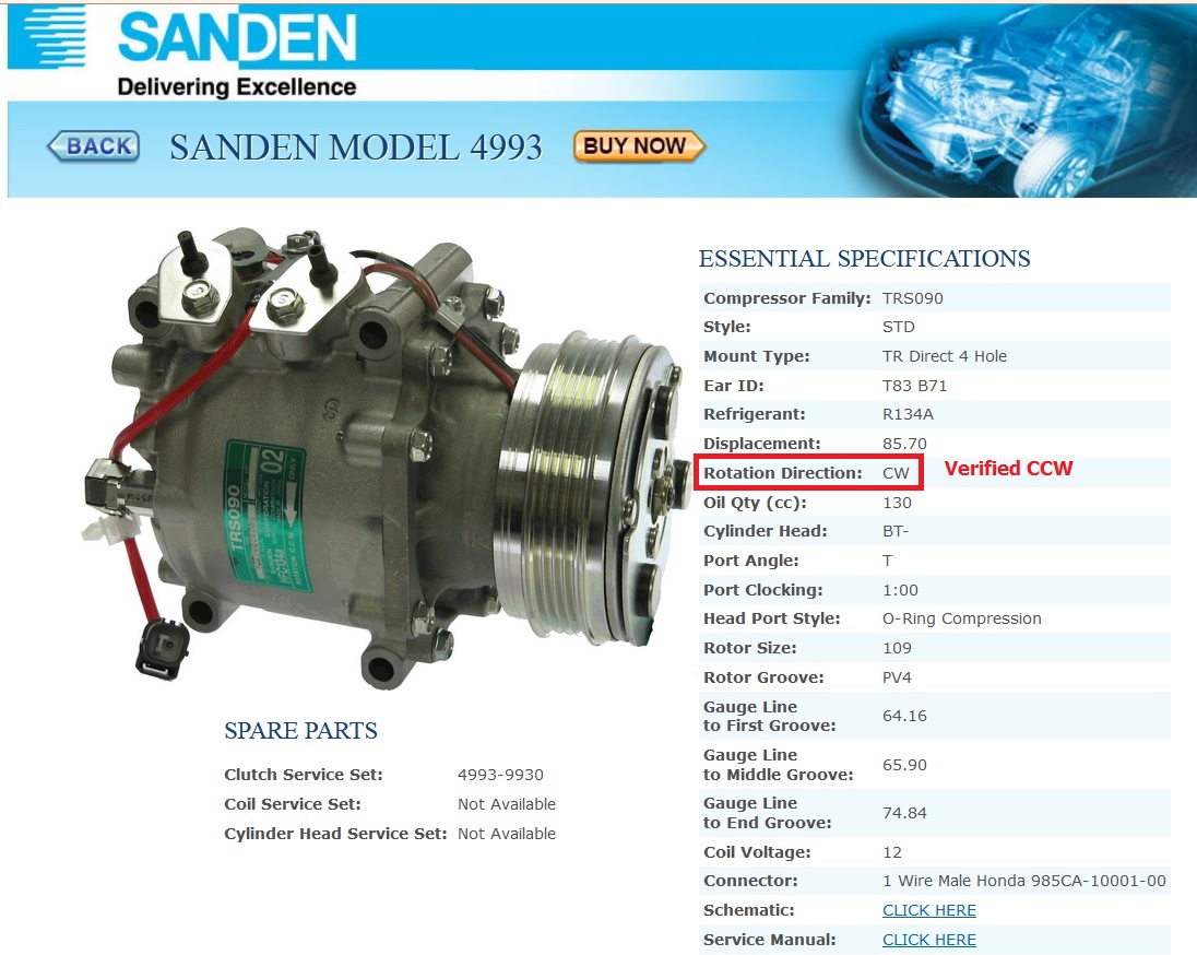

FYI, 4993 is recommended for CW applications. Civic is CCW. Wobble/swash plate compressors shift anti rotation gear full engagement verses piston TDC to advanced timing to reduce noisy backlash in CW rotation only. The OEM scroll is CCW only. The piston substitute for OEM scroll will be noisier but durability is fair. Sanden Singipore has one CCW piston model. You might review if your old scroll is OK.
hotrodac
Re: Plans for 90 civic A/C rebuild with newer gen Sanden compressor - remaining questions
Posted: Thu Apr 20, 2023 10:50 am
by 90efAACIF
A couple of weeks turned into a month (visitors, taxes and doctor) but I'm back.
Post by ice-n-tropics » Mon Mar 20, 2023 1:40 pm
hotrodac
Ice-n-tropics apparently saw the same incorrect info that I saw (on Sanden's website of all places). The 4993 is CCW only. All pics of the 4993 label (USA and Japan mfg) show CCW as does the spec drawing. Go to: sanden.com home page and enter 4993 takes you to: sanden.com/product.php shown below.
my label:
I'll post a few new questions in the next day or so.

ice-n-tropics wrote: Mon Mar 20, 2023 10:40 am FYI, 4993 is recommended for CW applications. Civic is CCW. The OEM scroll is CCW only. You might review if your old scroll is OK.
hotrodac
Posted: Tue Apr 25, 2023 9:31 am
by ice-n-tropics
Jim,
Sorry we had to deal with confusing Sanden's screwed up spec for wrong rotation . Hopefully others will benefit. I will cross check all available info, as you did, in the future.

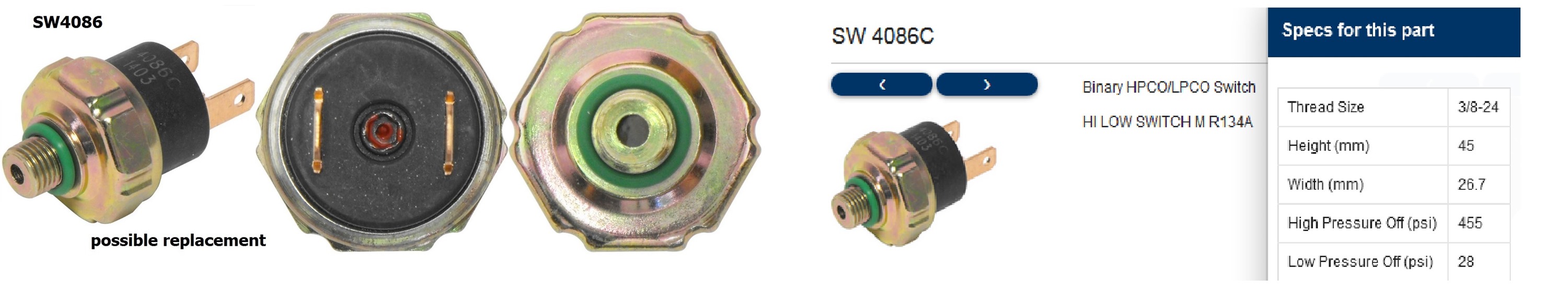

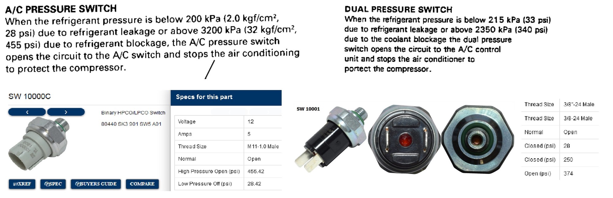

1) Binary HPCO/LPCO pressure switch replacement:
Besides the facts that the original binary switch is 32 years old and the crimped portion of the case is badly corroded, I think it makes sense to change to a higher pressure cut-off for R-134a as spec’d for the ‘94+ Civic. No one on the Civic forums has suggested this, but it should have a big advantage in very high ambient temps / humidity as we have in Florida.
From the ‘96 manual for R-134a: ------------------------------------------------- From the ‘90 manual for R-12:
Replacement from the UAC catalog for '96 ------------------------------------- Replacement from the UAC catalog for '90
Since the thread size is different I looked for one with similar pressure specs to the SW 10000C that will fit and found this:
This switch is sold under many brands (omega, santech, GPD and more) but all I’ve seen online have identical labeling on the plastic case. This will need a new connector which I have also found.
Next topic tomorrow...

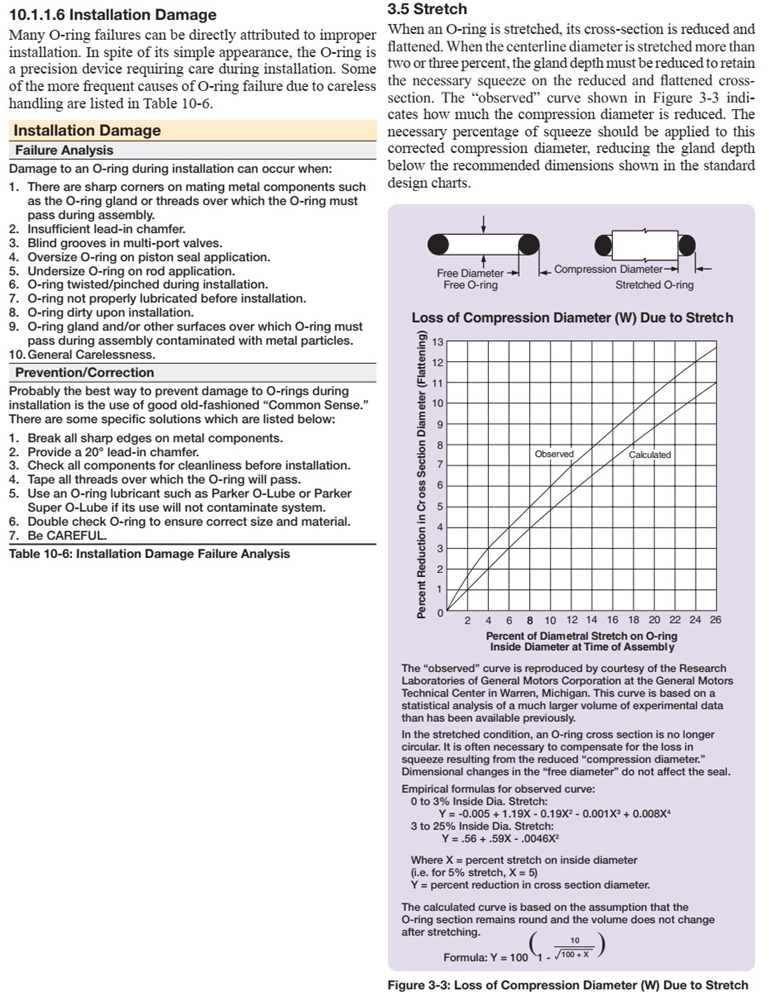

I strongly advise anyone who needs o-rings to work and last to download the "Parker O-ring Handbook, ORD 5700", easily googled 9MB pdf.
Having done that and perusing this 292 page compendium I have following takeaways:
There is more info than can be absorbed in the time that most people have available.
If you are interested in only auto a/c systems there are a few things to note. Damage during installation and stretch due to sizing error.
From Parker's Handbook:
The topic of O-ring stretch suggests that very small amounts of stretch (“more than 2 or 3 %”) needs to be taken into account for a good seal. That implies the replacement o-ring was accurately sized, which might be a tall order.

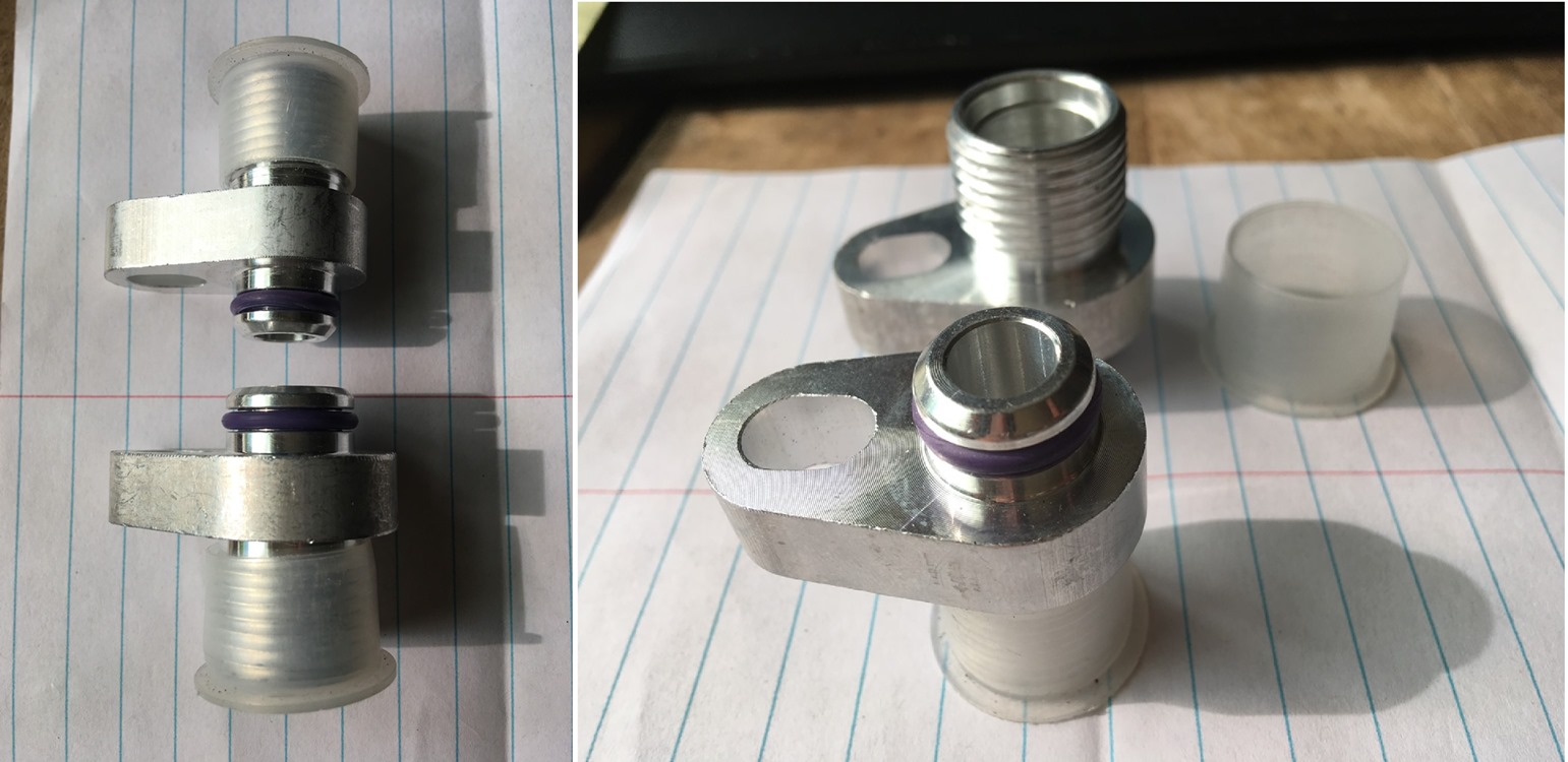

Finally the compressor manifold adapters I found on AliExpress are shown below. Note the purple o-rings included which I am inclined to replace with known quality. I also don’t know if the included o-rings would give the proper compression for a good seal. I used to have access to a good caliper before I retired. Time to get one for myself!
