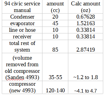

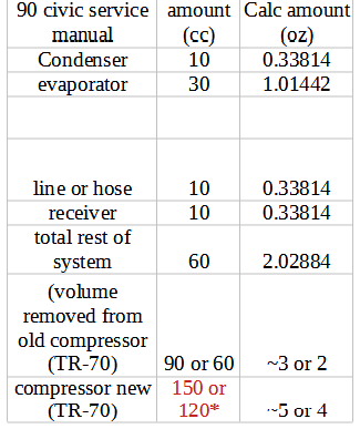

The following info was taken from 1990 and 1994 Civic manuals. I didn’t bother to round my cc to oz conversions. I know it’s ridiculous!!!
table oil90.png (11.58 KiB) Viewed 10709 times
*the 1990 used either one of two compressors Sanden or Matsushita
table oil94.png (11.88 KiB) Viewed 10709 times
