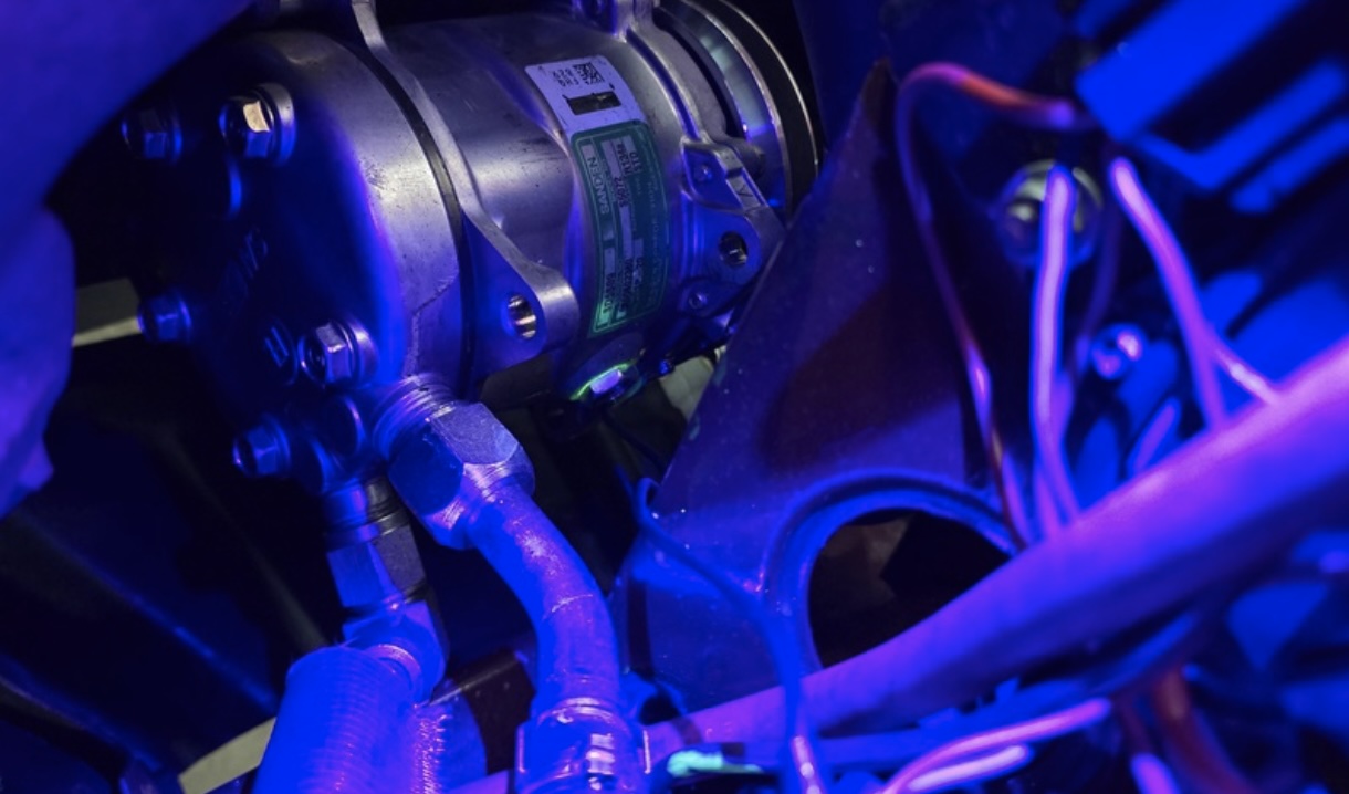

What size O-ring should be used on an oil filler plug? My local shop tech says there is a leak there.
leak photo.jpg (168.38 KiB) Viewed 39649 times
Posts: 1062
Re: Sanden compressor plug leak
msrichmond wrote: Fri Sep 05, 2025 2:30 pm What size O-ring should be used on an oil filler plug? My local shop tech says there is a leak there.
Once the refrigerant has been recovered, simply unscrew the plug and match up with a new green NBR O-ring. O-ring seal plugs and fittings should not be overtightened.
