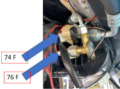

When you say you are measuring the pipes coming out of the evaporator, do you mean the inlet pipe (going from TXV to evap) and the outlet pipe (going from evap outlet, has bulb attached, goes to the compressor)?
When you calculate suction superheat are you taking the pressure at the service port and the temperature at the service port?
If those in/out pipe temperatures are to be believed (do they feel like they are in the 70s with your fingers?), your suction line pressure drop is what's killing you.
Also, how much oil do you have in there?

Re: Installing Aftermarket AC in a Dodge Van
OK, but you measured those temps where I'm pointing in this picture, correct? 76F after the TXV, before the evaporator? Please confirm
I don't think adjusting the TXV was good advice based on this,
