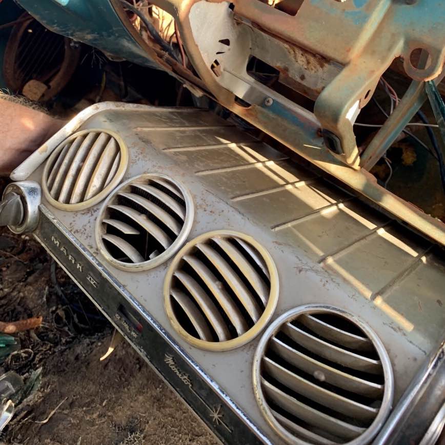

Looking for history on Mark IV evaporators. I would like to know what years were which?
The models such as Allegro, Monitor and Escort model. I have not seen the escort model . I have done some googling, reading but have not come up with years. The best I can do is match advertising to the dash on the car. The top one seems the most rare to me.

pic #1 was popular as a beer cooler when louvers are removed and holes just fit a beer can.

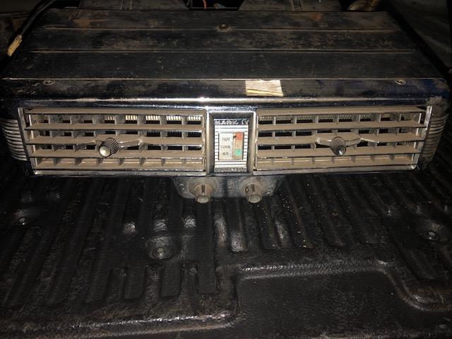

Pic #2 established my level of progress in AC development after I went to work for $2.50/hr in 1960 at age 18. Made every drawing on this Monitor and traveled USA to die casters etc. to get tooling. Didn't own a suit or tie, what a hoot. Kept a Machinist Hand Book and idea note pad on my bed stand. Coil tooling machinist said he could just scale my fin, end frame, tubing drawings (they were spot on accurate). Had to add 12" to left edge of large drawing to define last minute addendum of grooves on each end of die cast chrome bezel. Toolin machinist in Chicago over machined mounting holes so I used over size screw heads. Unscrew a bezel fastener and see. Now I draw my pine country lake cabin floor plan and framing ( Lake at intersection of ACR 403 & ACR 414 in Anderson county).

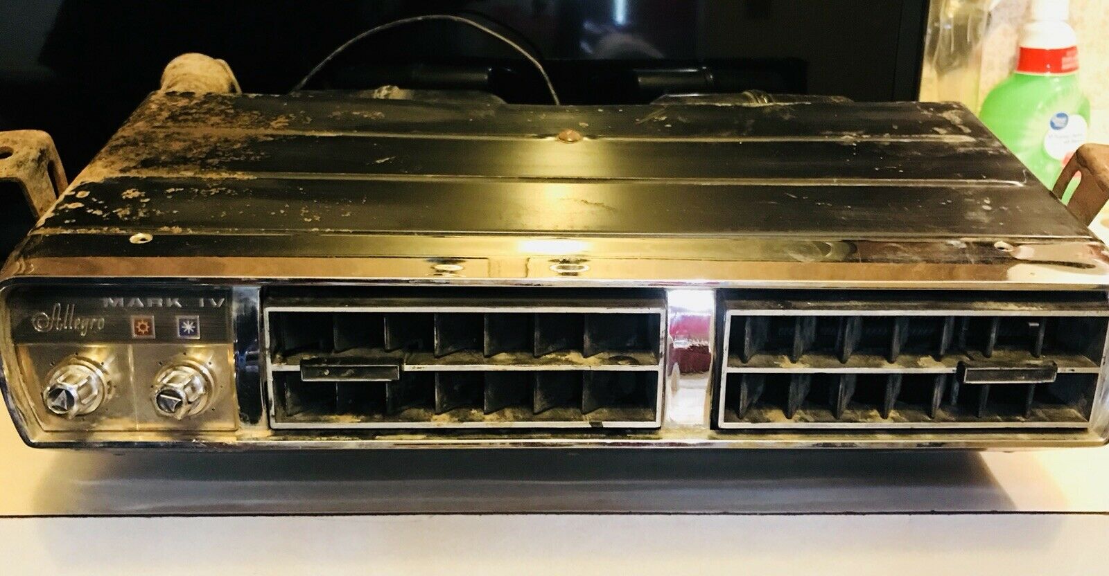

For Ice n tropics would it be beneficial to look for an older mark IV allegro like the one pictured vs using the newer repop vintage air mark IV? I know you said the older ones had more BTU's.
I know I've read others using an older evaporator with newer sandon compressors, condensers, lines etc and having good results.

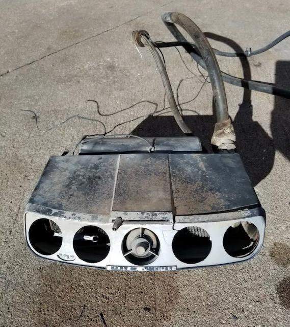

Pic 3# was replaced by Pic #1 to look cool.
Made all drawings on Allegro then installed it in my 56 Chevy refrigerated meat PU for many years. Only problem is I needed a windshield wiper on rear window. Colder than a Alaskan's well digger's rear or a witch's breast in a brass bra.

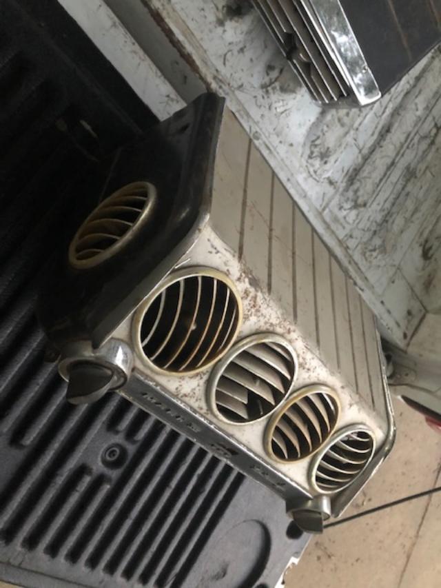

It’s nice to use your parts car as a mock up.
