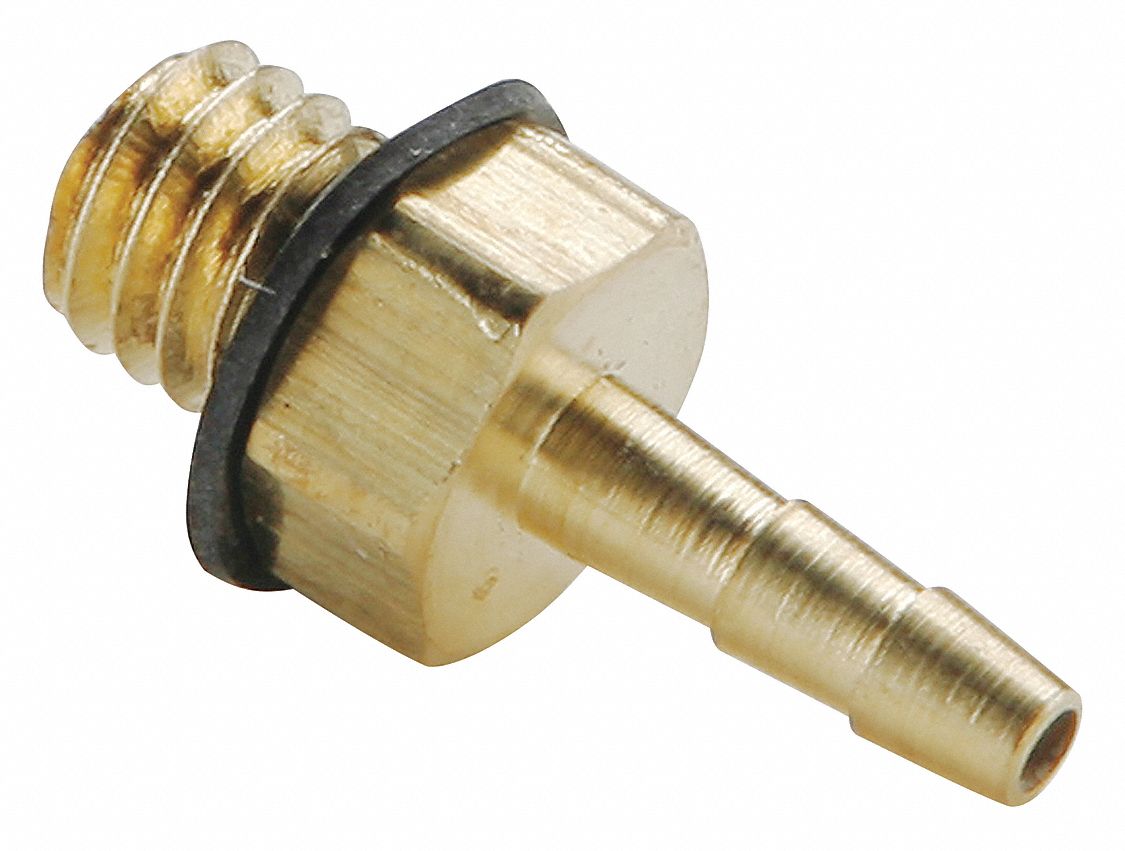

Now, if you look at the compressor image, you'll see that this system doesn't use proper fittings, just hose clamps that seem to be these.
So to hook up old and new parts, I'd either need to use fittings like these and use standard hose clamps, or try to find flat fittings and use the AC hose clamp. Or buy the not-so-cheap press-flitting tool and make the proper ends to mate to the Sanden compressor and the drier.
