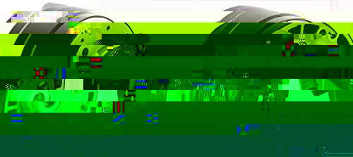

While looking for a new R4 Compressor, I found an aftermarket company making a new GM R4 but in a Scroll design! No Pistons. I would think the Scroll type with less moving part would me more reliable. They are on eBay and Amazon. The pulley is smaller than typical R4 use spin the Scroll faster I assume.
I do find it very interesting that this company went out of the way and decided to re-engineer the R4 instead of cloning it. See the back picture of the compressor. It appears that it is a small scroll housed in same case. I am sure there are no large o-ring under the black steel case which has been leak issues with the original R4.
This eBay listing clearly states its a Scroll. If you look at the inner Aluminum Case, it is completely different. It does not have the 4 bolts that holds the front cover.

Looks like a Trash-90 crammed in an R4 can with a fresh casting.
Pulley looks to be the same size as an R4 - care to give us an actual measurement?
Since you seem to have pics that are not on the e-bay link you posted, are you selling this product?
"Better than piston type?" Better at what? A performance curve would be the only answer.

I have unique application. I am installing AC in my 1964 Falcon using Explorer 5.0 timing cover and short water pump so need a very short AC Compressor and the R4 fits the bill. I have a bad R4 that I used for mock up. I made my own brackets and spacer and R4 fits really nice. I have not found any AC compressor that is shorter than the R4. No not selling anything. Just looking for something little better as most people says that R4 is not a good compressor. From the reviews on Amazon, the pulley is actually smaller than typical R4.

Maybe I'm missing it but looks like a normal UAC R4 to me.

Every scroll I have run or seen on current vehicles have a need for speed- every one of their owners complain of no cooling at idle. Suction pressure is in the 60s at idle- will drop to 30s at 3500 erpm.

The pulley on that scroll /R4 is the same size as a stock R4 - compare the pulley OD to the mounting holes in the case.
The R4 is short. There is not enough room to put a TRS105 in it's place. So the more likely thing is a new outside case for a TRS90 to mount it in the old R4 can.
A TRS90 (or even a 105) would need a 50mm diameter belt pulley to spin fast enough to come close to the output of an R4.
As ice already pointed out in the other thread the TRS105 was a dismal failure in the Trailblazer.
Technically the HR980 compressor (Ford YC-177 1983-88 Mustang) is probably more compact - and possibly a worse choice than an R4
I would pick up a V5 or V7 core & start on a new mount.
