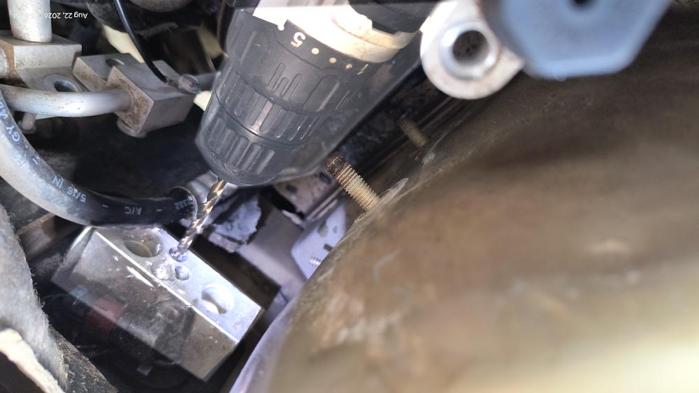

Well, my patience ran out, and the torx slot started wollering out.
After trying to work the bolts back and forth for about an hour, applying PB Blaster along the way, and getting nowhere I decided to drill the heads off the bolts.
I can tell you that trying to do that with HarborFreight Titanium drill bits doesn't cut it. I can give the Titanium bits an honorable mention against the grade 8 or grade 10 hardened bolts, but they were definitely not up to the task.
Fortunately, I also had a set of HarborFreight Cobalt bits and alas, they made quick work of those same bolt heads. It really is an amazing difference.
So with both bolts decapitated......I still can't get the expansion valve off (yet). Not sure what's holding it? It wiggles and moves and has about 1/4 inch gap between the mounting block and the Exp Valve, but it just won't let go and slide out. I kept thinking it was a small bit of the head of one (or both) bolts still hanging on just enough to keep it from coming off, but no matter how much more I drill the bolt studs....no go.
I can't say this job is a whole lotta fun at this point.
In the photo below, you can make out (barely) the remaining stud of the now decapitated bolts. Bad angle. I'll try to get another better shot and post it.
I'm going out now to get a small diameter punch and play Whack a Mole with those decapitated studs to see if I can get them to let go.

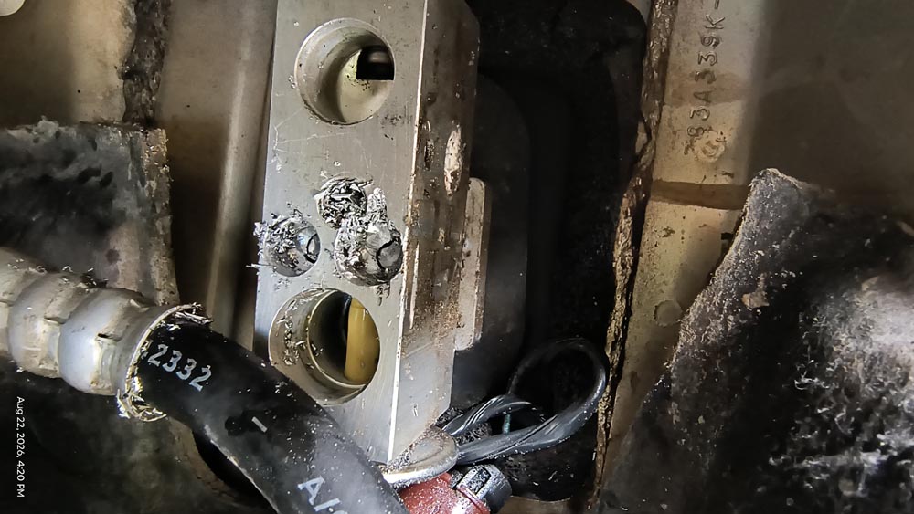

Re: Badly stuck expansion valve bolts
Posted: Sat Aug 22, 2026 1:44 pm
by Diametric
Anyone else see that strange looking section of hose next to 2332 in the photo above?
I need to investigate that. I wonder if that could be a defective hose that is collapsing under vacuum or just an optical illusion?
Re: Badly stuck expansion valve bolts - Dodge Grand Caravan
Posted: Sun Aug 23, 2026 7:49 am
That hose is strange looking, all right. It appears to be formed that way, but who knows? Dodge might have done that for clearance purposes.
Posted: Sun Aug 23, 2026 12:02 pm
by Diametric
JohnHere wrote: Sun Aug 23, 2026 7:49 am That hose is strange looking, all right. It appears to be formed that way, but who knows? Dodge might have done that for clearance purposes.
What year is your van? Using the year, you could look-up the van's OE A/C parts and see what turns up (whether the replacement line is the same).
Hello JohnHere!
Yes, strange. Now that I just got the expansion valve out I'm going to take a close look at that hose.
