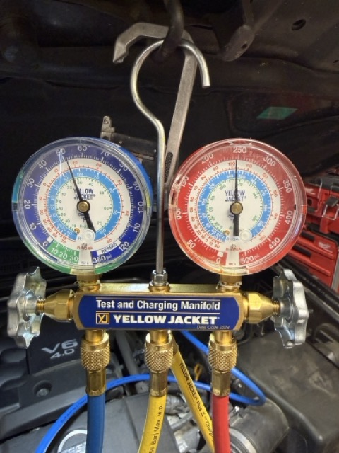

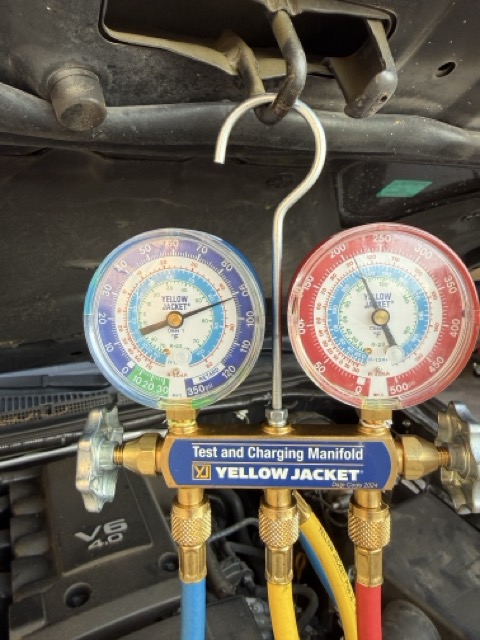

Hello, need some help in troubleshooting my truck.
I’m not professional HVAC tech, but did my own compressor/radiator/valve replacement, vacuum pull and recharge AC on my old car.
2019 Nissan Frontier, 70k miles. Rebuild title. Was hit at right front side. Own almost a year.
AC is barely blowing some cold in Texas heat. Compressor works on and off.
Static pressure was around 100 psi with 95F ambient temperature.
I drained some freon.
Didn’t help much. Attaching video of gauges.
Need some guidance.
Gauges recording: https://youtube.com/shorts/1Hh5JaIMgZU?feature=share

I suggest reclaiming the refrigerant. Pull a vacuum, add back the specific refrigerant, and post your readings. You did not list engine size.
Refrigerant Type: HFC-134a
Refrigerant Capacity: 1.54 ± 0.11 lbs
Refrigerant Oil Type: PAG Oil Type R (DH-PR)
Refrigerant Oil, Total System Capacity: 6.087 ± 0.338 fl oz
Refrigerant Oil, with Condenser Replacement: 2.54 fl oz
Refrigerant Oil, with Compressor Replacement: Balancing Procedure
Re: 2019 Nissan Frontier AC troubleshooting (Video link attached)
Posted: Mon Aug 10, 2026 1:58 pm
by mcFish
Tim wrote: Mon Aug 10, 2026 1:54 pm I suggest reclaiming the refrigerant. Pull a vacuum, add back the specific refrigerant, and post your readings. You did not list engine size.
This is what I've been thinking about as first step!!! Will do.

No offense, but I'm going to disagree. An expansion valve system should not run at 40 PSI during high idle. He needs to get back to the OE specs; otherwise, they are just guessing at the problem. If 40/300 post OE spec. Then you can start working on the problem. Might spray a mist of water on the condenser while running and see if pressure drops and cooling begins.

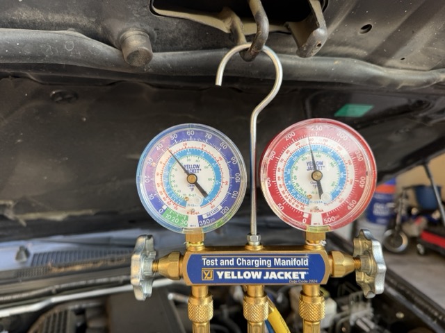

Pulled the vacuum, recharged 24 oz. Didn't help much.
But at least static pressure is 70 now at 95F.
AC working in same sequence - short start/stop.
Took it for a ride - min air temp from vent - 68F.
Attaching gauges video: https://youtube.com/shorts/0Quf4k-mAGo?feature=share
Running pressure now 50/250
System spitting out a lot of yellow dye.
Possible someone tried to find a leak and dumped stop-leak goo?

Mist the condenser and post pressures & temp.
