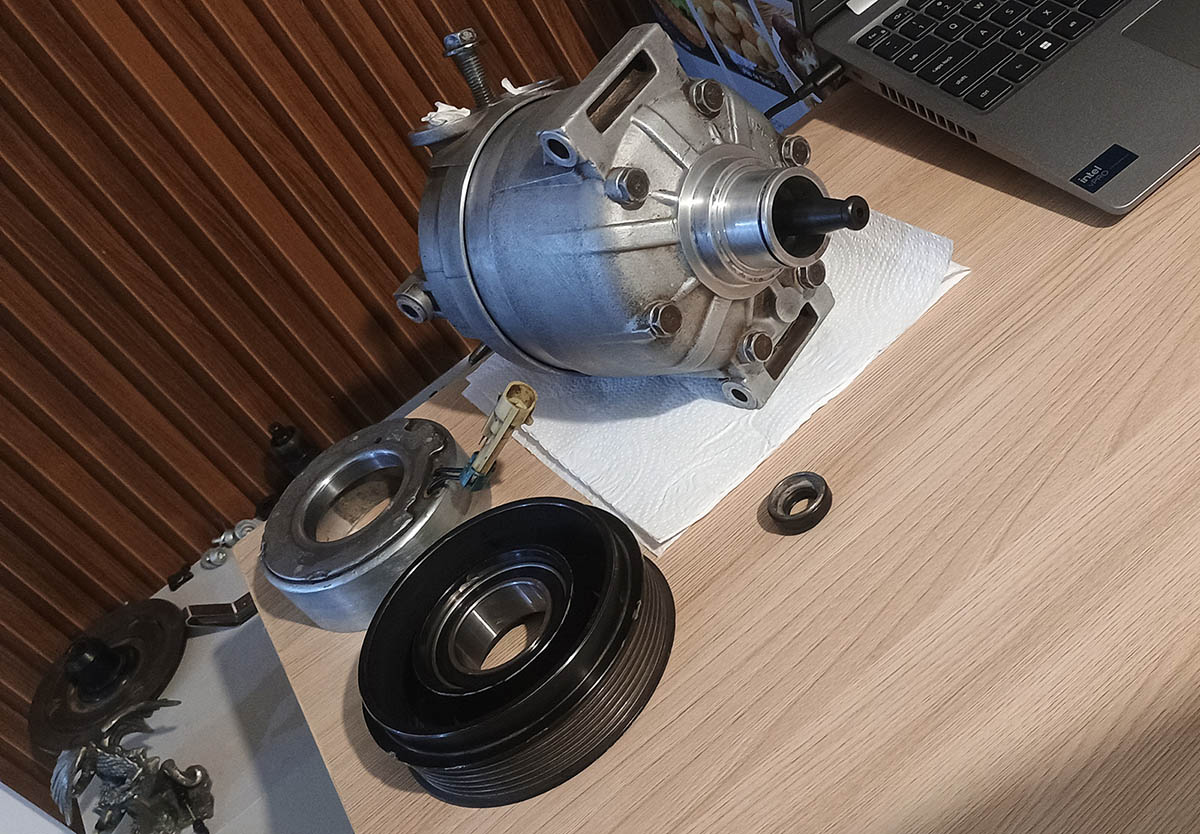

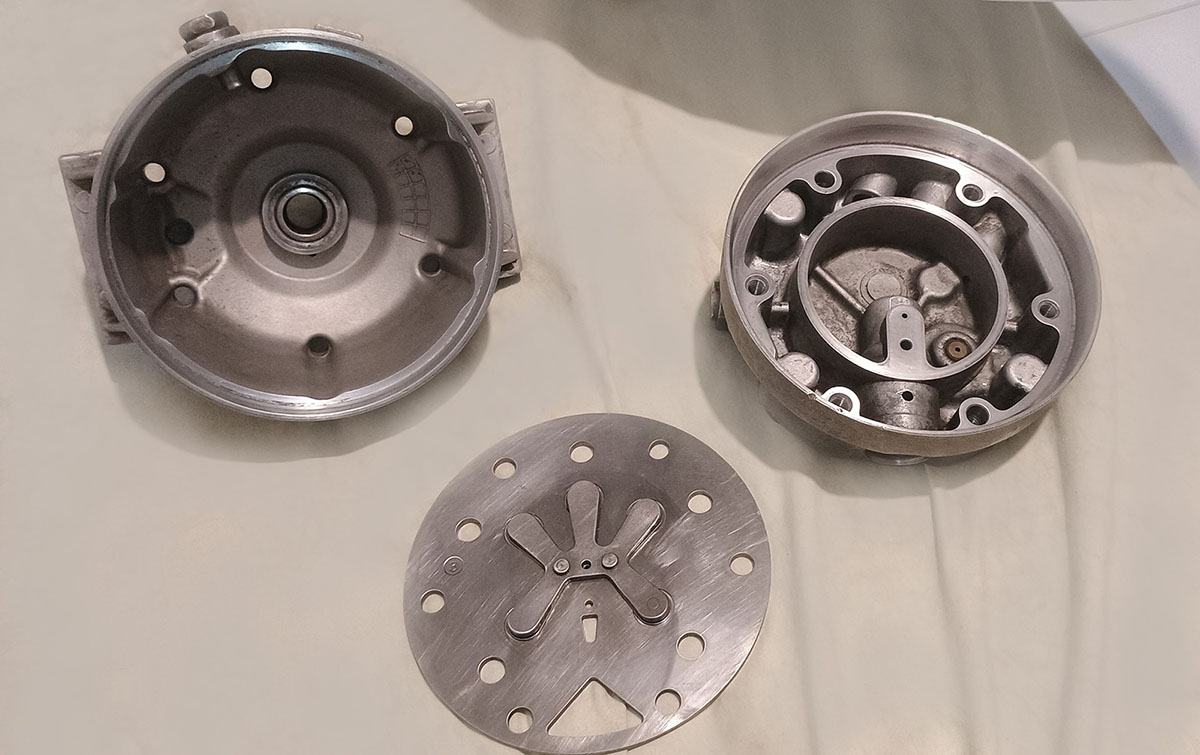

Disassembling the compressor, solvent cleaning only the case but not the piston assembly, probably was okay as long as you blew-out and dried any remaining solvent beforehand. This presumes that you didn't introduce any dirt or grit into the compressor on reassembly.
Did you also replace the shaft seal while you had the compressor apart? If not, the seal might leak at some point in the future.

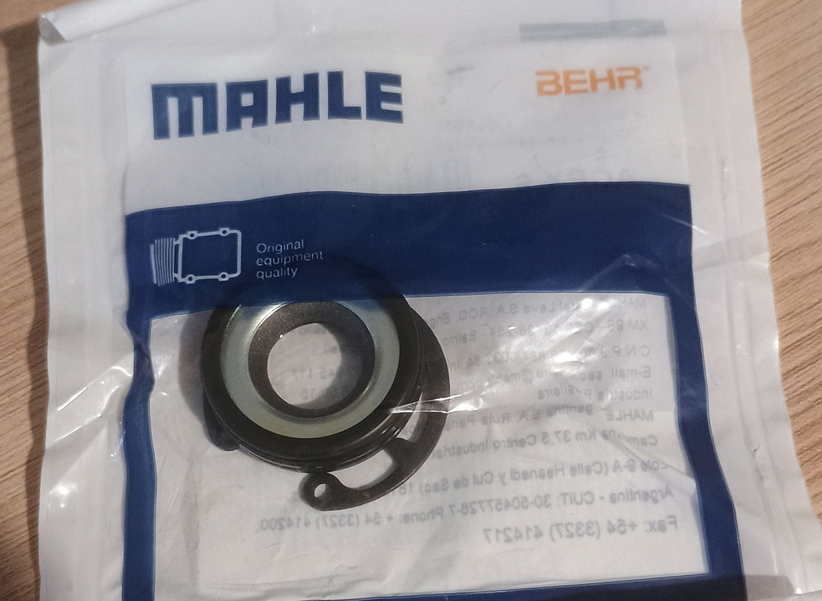

Yes I took the compressor apart and replaced the seals, fine grid sandpaper to clean the shaft and guide to not damage it. It was in fact one the main sources of leakage.. also replaced both hoses that leaves the compressor, the exp valve, dryer filter, and tower valve. removed the evaporator to check for leaks (was all dry) and cleaned it + the air box (was disgusting, full of leaves and dirt/hair there) also bought a set of o-rings and replaced everything I touched.
