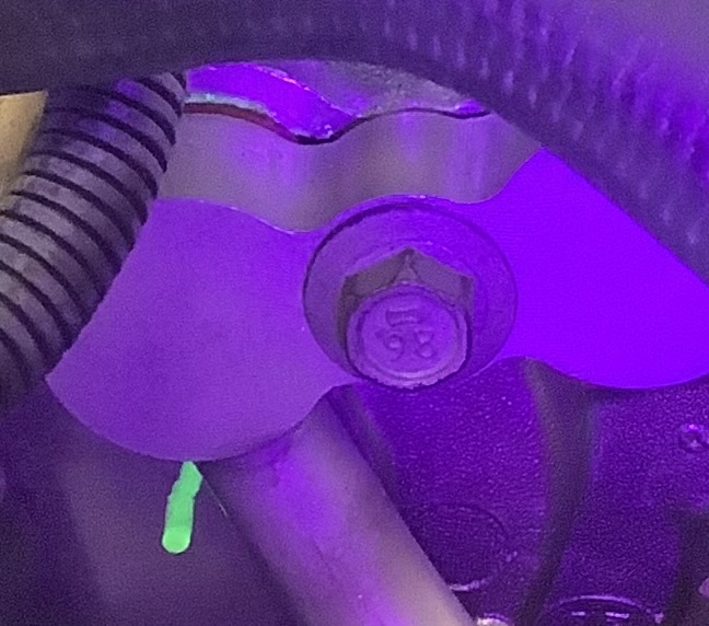

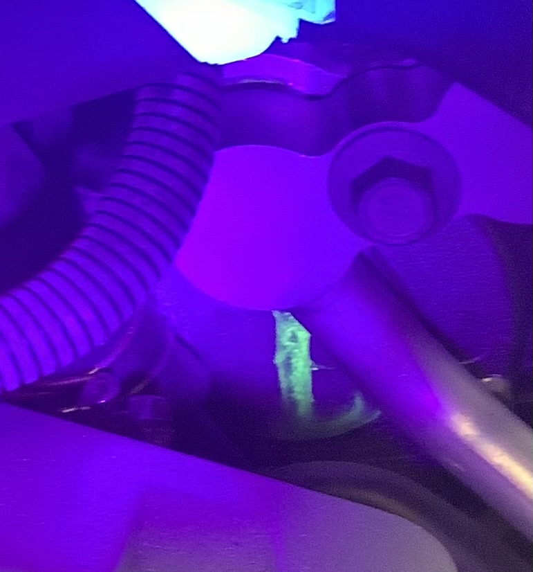

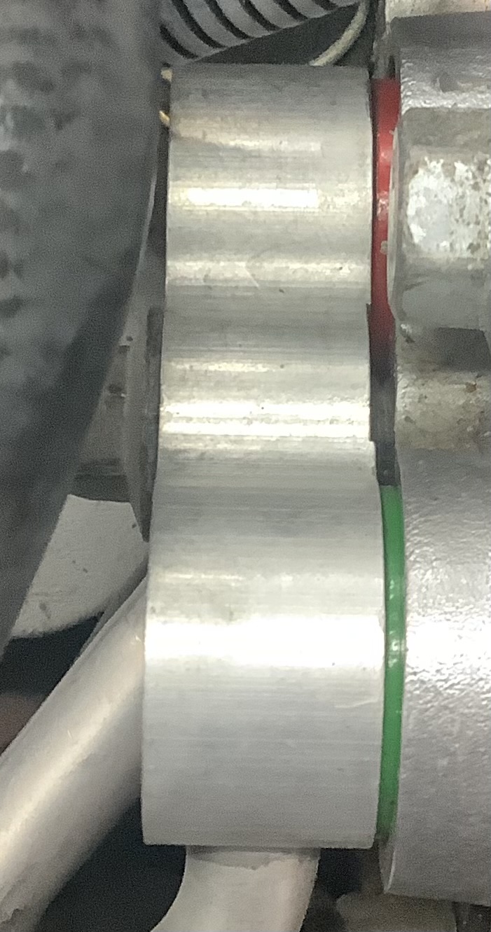

In the meantime, I have found the leak. It is leaking from one of the seals behind the R4 compressor.
I cleaned it all up and ran it for a short time and shut it off and I can see where the new oil is leaking back down through that seal, why did he not find the leak to begin with?
I want to change those two seals on that r4 compressor but I don’t want to have to flush any of this. What do I need to do with this?

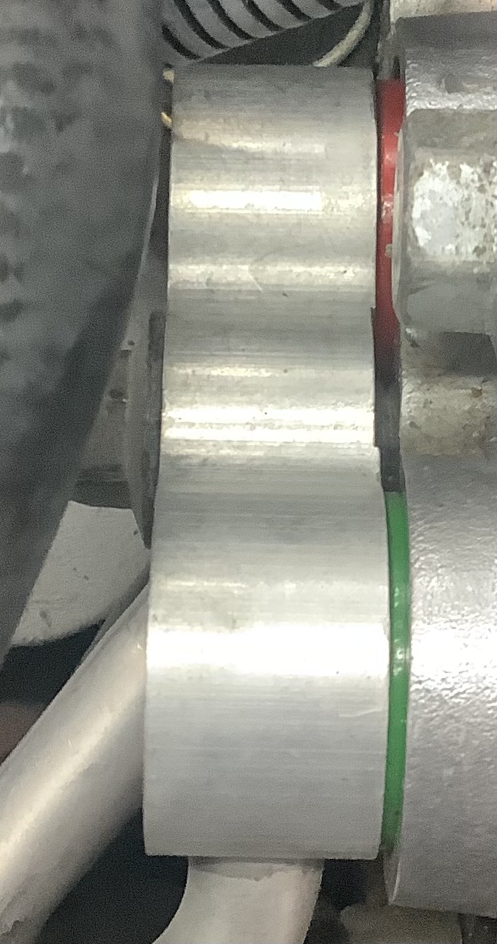

It looks like I used the wrong seals initially. That red seal should have been the gold colored one.
Is there any thing I could put around those two seals on the compressor to stop a leak there?
If I disconnect that main line connected to the compressor to change those seals, can I get by with just changing the accumulator?

It's been quite a while since I worked on that particular model-year vehicle, but I seem to recall that the compressor and manifold have shallow circular reliefs cut into their respective flanges, into which the seals fit. Then the center bolt is tightened to partially compress the seals to such an extent that the flanges meet. I don't recall the sides of the seals showing as they are now. Seems like something's wrong there.
That picture showed the wrong seals that I installed. I have since installed the correct seals. In place of that red seal, there is now a gold colored seal that is larger in diameter and fits properly.
Also the back of that new R4 compressor has stepped ports that require these washers where as the original ones used orings that allowed the block to seat to the back of the compressor.

When using sealing washers, there will be an intentional "gap" between the compressor rear head and the air conditioning hose assembly block (suction discharge block assembly). Do not mistake this as a loose connection or a mis-assembled joint.
I added 2 oz pag oil to the accumulator and pulled a deep vacuum down to 310 microns and holding steady. I am getting back to the shop Friday to have it charged.
