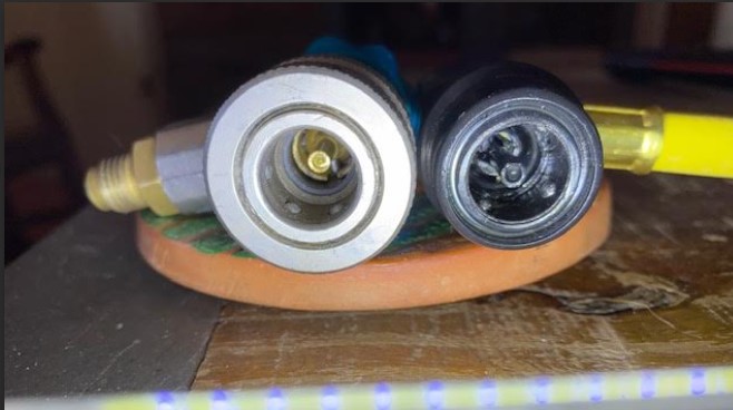

LPS HOSE FITTINGS.jpg (48.58 KiB) Viewed 101092 times
I just checked on my 2005 Jeep TJ w 4.0 it has the same scharder valve depth.
Here is a photo of the LPS fitting in my 15 year old Manifold set and a can to hose to LPS fitting that was included with some cans of r134 I got from Ebay.
Note the locking balls are at the same depth but the plastic LPS has the schader valve depressor sit uo at a depth of the locking ball while my old fitting thr depressor sit down deeper than the locking balls.
I have never needed to add any freon to my jeep.
But had to top off the Mazda so I used the plactic LPS one.

Also, make sure that you rotate the thumbwheel on your adapter clockwise to open the port, which is not intuitive.
Do your adapters look like these? If so, they should work.

Examine the depth to the depressor when the knob is in the open position vs the closed position.
I have seen the depressor knobs marked backwards.
