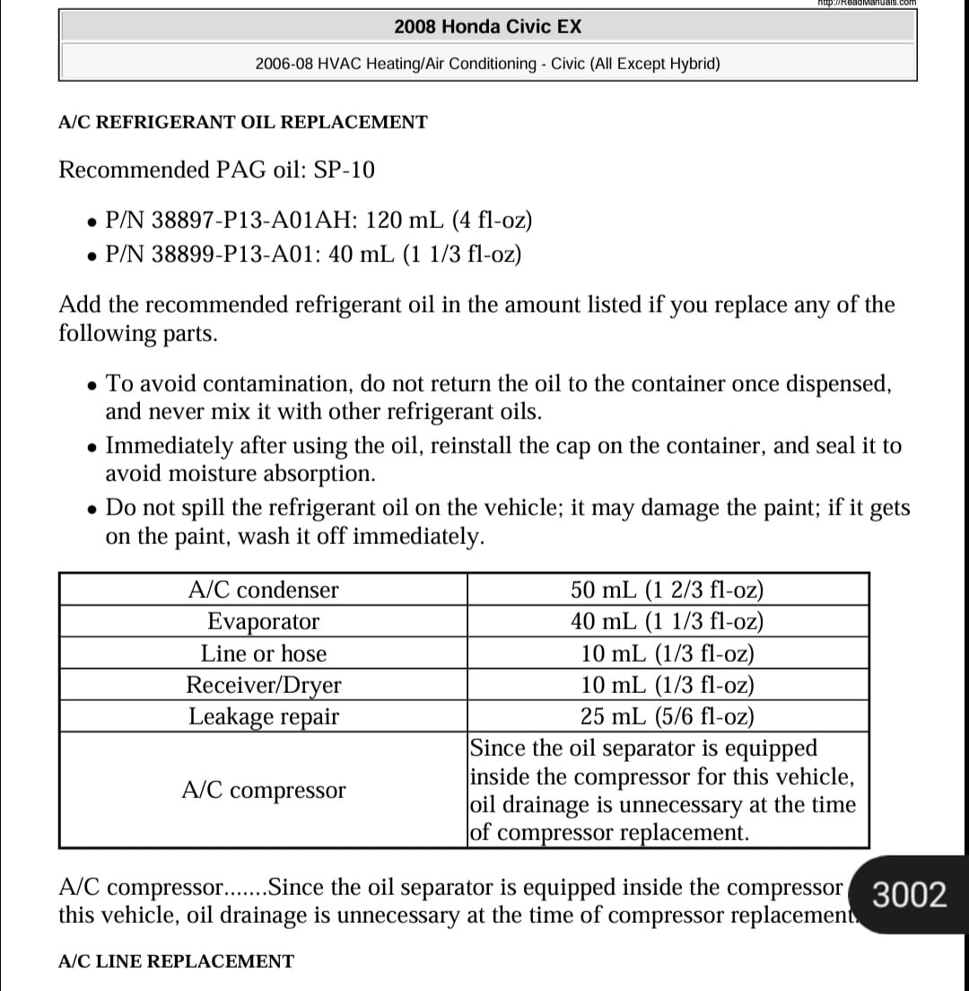

So I changed the condenser and added 50ml or 1.7oz of PAG46 oil in the larger hose of the condenser just as the service manual says, I felt that it was too much oil, but I decided to do what the manual says.

Update: I just realized that the manual says civic 2006-2008, so I guess that even though the 2011 is the same 8th gen, it should use a different amount of oil, but I'm not sure.

I think the oil amount that you added to the condenser assembly is just about right, if not a tad short.Legitness211 wrote: Mon Sep 23, 2024 1:52 pm So I changed the condenser and added 50ml or 1.7oz of PAG46 oil in the larger hose of the condenser just as the service manual says, I felt that it was too much oil, but I decided to do what the manual says.

The specs that I have for your car are 16 ounces net weight of R-134a, and 4.0 fluid ounces of PAG-46. If you have an under-hood decal with specs that differ, the decal takes precedence.Legitness211 wrote: Mon Sep 23, 2024 1:52 pm Update: I just realized that the manual says civic 2006-2008, so I guess that even though the 2011 is the same 8th gen, it should use a different amount of oil, but I'm not sure.
