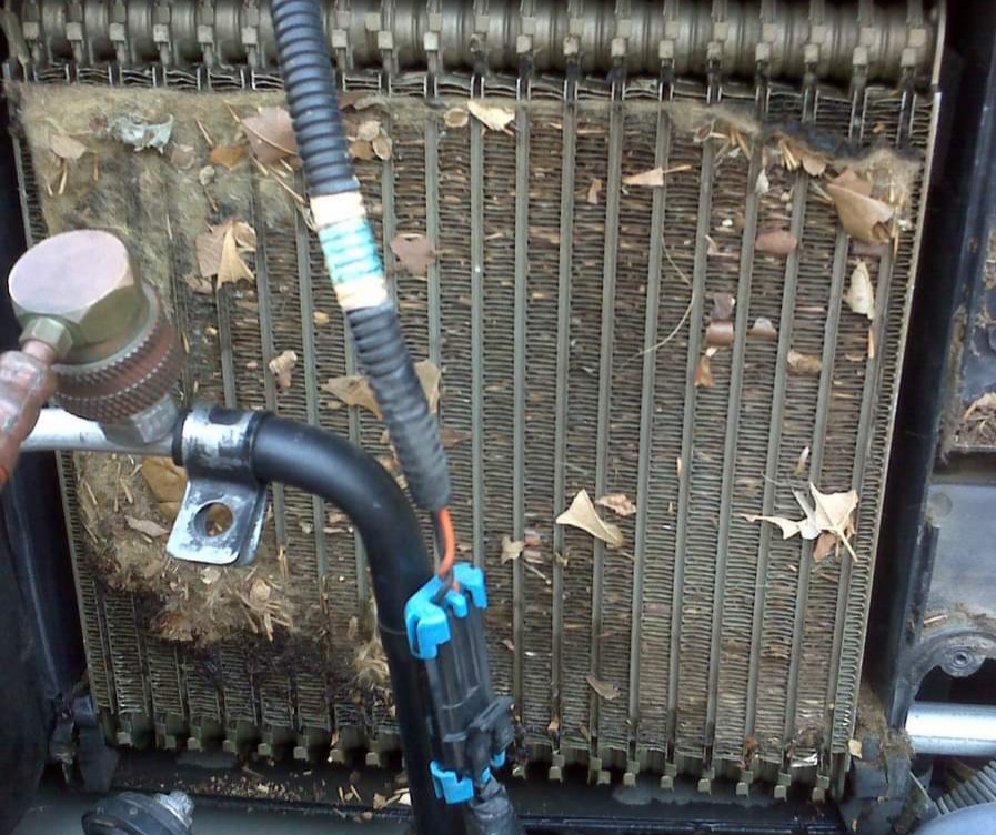

Front orifice tube size has always been wrong, especially on models with rear a/c. You will get better results with a Ford Red 0.062" tube up front. A dirty cooling stack, a rear expansion valve that is stuck fully open, failing compressor or mixture of all 3 will result in high low side pressures. What does the cooling stack look like? It needs to be clean all the way through. The evaporator cores also need to be clean. The front evaporator core is very easy to access from underhood by pulling off the blower case. The vans have never had a cabin filter thud the evaporator core becomes the filter and will need regular cleaning especially in a dog environment. The K9 units were some of the dirtiest a/c evaporators I have seen and that was on Tahoes and Suburbans that were practically new.

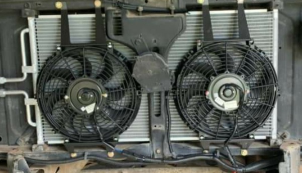

Typically the Express will have a transmission cooler dead center of the opening ahead of the condenser that is 11" wide. You should be able to get a pair of 11" pusher condenser fans listed for a 1999 Tahoe 5.7L application in front of the condenser. 1 on each side of the transmission cooler. Wire to a suitable relay with a fused power source, Painless 30101 is a great off the shelf fan wiring kit. Use the Orange high blower relay turn on signal wire at the front blower resistor as a signal to turn on the condenser fans. I would install a 4 port manual heater bypass valve. The heater hoses should come together above the passenger frame rail in the engine compartment allow the installation of said valve. Most of the newer GM vehicles rely on the heater circuit as a coolant bypass for the engine. The 4 port manual shutoff valve maintains the bypass but isolates the heater cores. Other than that look into a high idle setup. The GM diesel should already have provisions in the tune for it. The van may even be able to do it from the factory steering wheel control menus. The changes above should make a huge difference especially with a correctly serviced system.

Dual condenser fan setup on a GM truck. Van condenser is even wider.

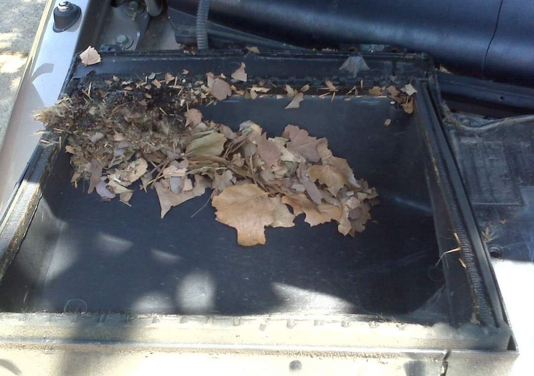

One other change I made. The rear of my evaporator had 3 layers of aluminum like window screen on the backside. I had a pinhole in the core and had to replace it when my 97 van was about the same age as your van. I moved one of those mesh screen pieces to the front of the evaporator core as a pre-filter. It has kept the actual evaporator core clean and the mesh is easy to clean through the blower motor hole. I use a leaf blower vacuum attachement and it easily pulls all the material blocking flow off the screen.

Here was the actual core. Absolute failure in GM design not having a cabin filter to keep all this junk out and 20+ years later they still build them the exact same way. The air intake is the cowl under the wiper arms. If you park within the shadow of a tree, cover the cowl vents with a beach towel or tarp and weight it down so it does not blow away. Drastically cuts down on this buildup especially if the van is not driven daily. This sat in my parents driveway for the first 15 years of its life, next to a 115ft tall sycamore tree in the back yard. That tree was responsible for 95% of this buildup.
