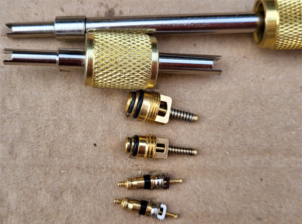

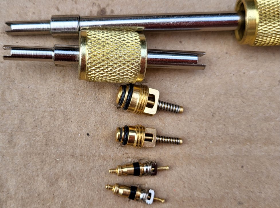

Purchased a set valve core for Chrysler from Rockauto, plz see the attached pix. The valve cores have difference between hi/low side. The removal tool have a groove on its each end, a wide one for large core, and the narrow one for small core.

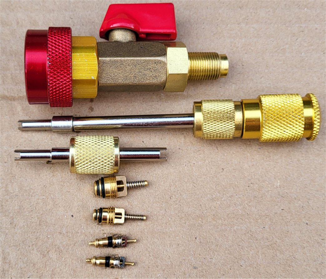

The new question is about removal tool for non-discharging system. See the attached pix. The high side tool only has narrow groove tip, which does not fit my application.
I did search in Amazon, based on posted picture, all hi/low side "fancy" removal tools have same size groove.
Please shed light on the direction, where I can buy valve removal tool.
The non-discharging system hi-saide removal tool has same size groove as the regula removal tool low-side one.
