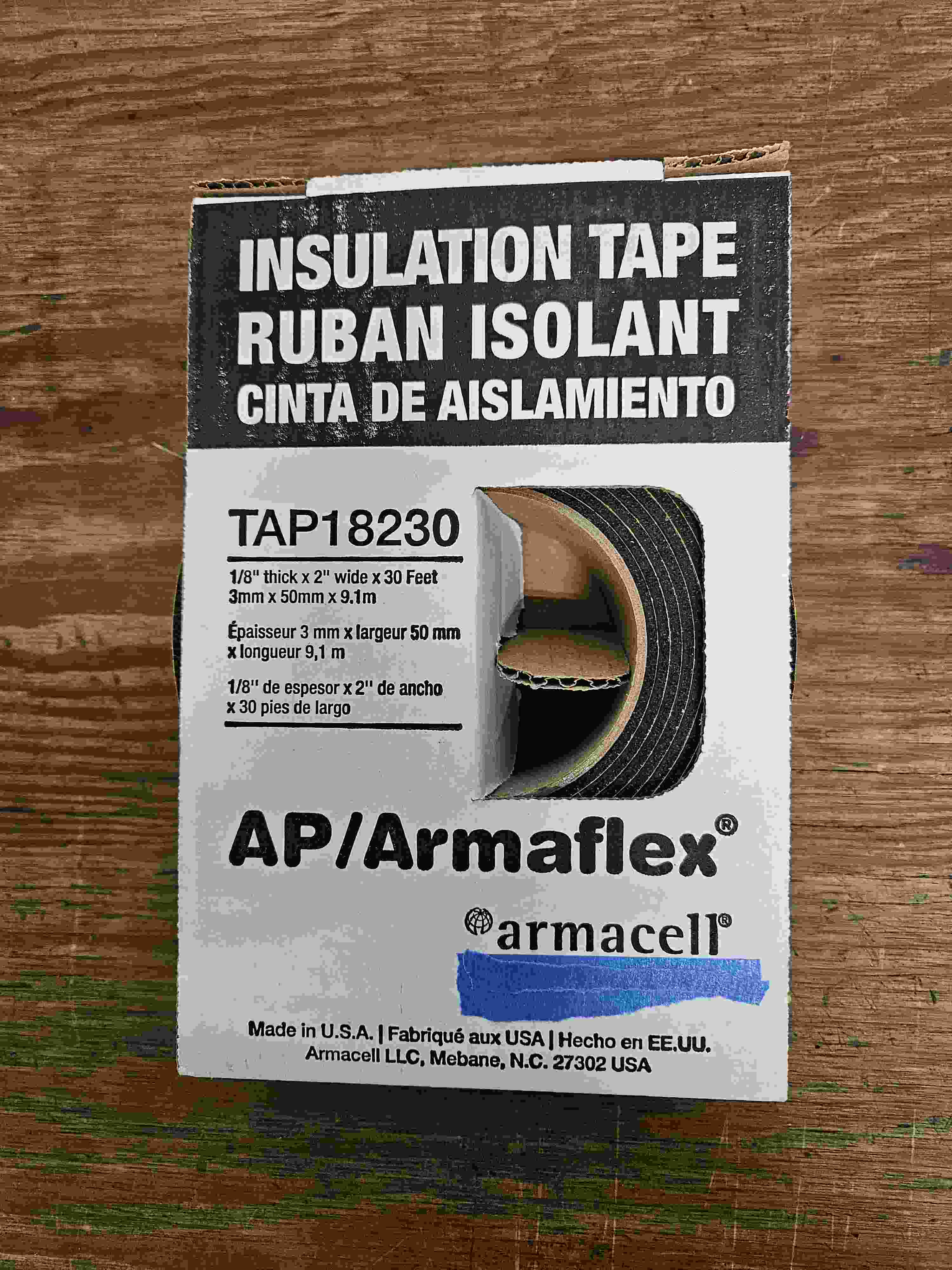

Grainger's has what they call "Oil-Resistant Buna-N Foam Rubber Pipe Insulation" that can be used for just such a purpose. Buna-N is flexible, and the sections are available in various lengths and ID's. They have to be slit, as already mentioned. The slit and the ends can be sealed using the pictured tape, available in the Orange Home Center.
