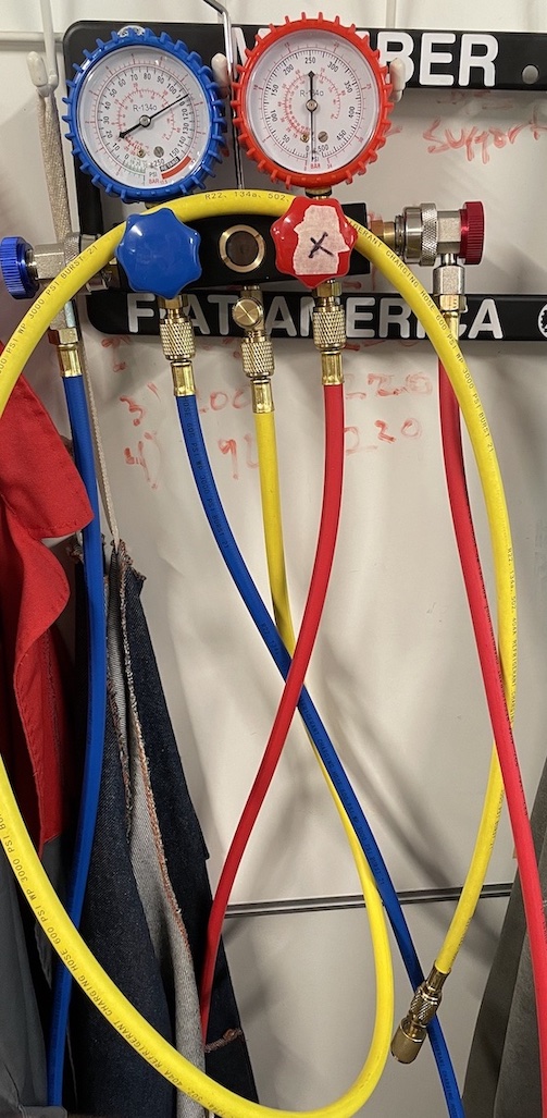

I am certain that refrigerant is getting into the blue hose. I don't think it's getting out.
Here is a photo of my MGS hanging on the wall after I closed the blue valve after losing about two ounces to purging. The pressure is all in the hose still, and in fact, my high side vacuum is still showing.
I'm headed to AutoZone to rent a different MGS. If that does not work then I would suspect the schrader valves on my service ports.

I would be more suspect of the couplings on the MSG.
The cheapo sets are famous for have the wrong tolerances machined into the parts. Then what happens is that the shraders on the car do not get properly depressed.
I myself have had this problem and I should have gotten my MSG from Tim when my old one finally died.
Be warned that rental stuff often has been abused especially by ppl who have no idea what they are doing.
Everyone says, hey how bad can AC be, anyway, well just shove in some Freon and be on our way!!!
If only it were that simple!

Guilty. I bought another one from Harbor Freight. $69 with two cans of R134a thrown in for free. It worked.tbirdtbird wrote: Sun Jul 07, 2024 3:01 pm I would be more suspect of the couplings on the MSG.
