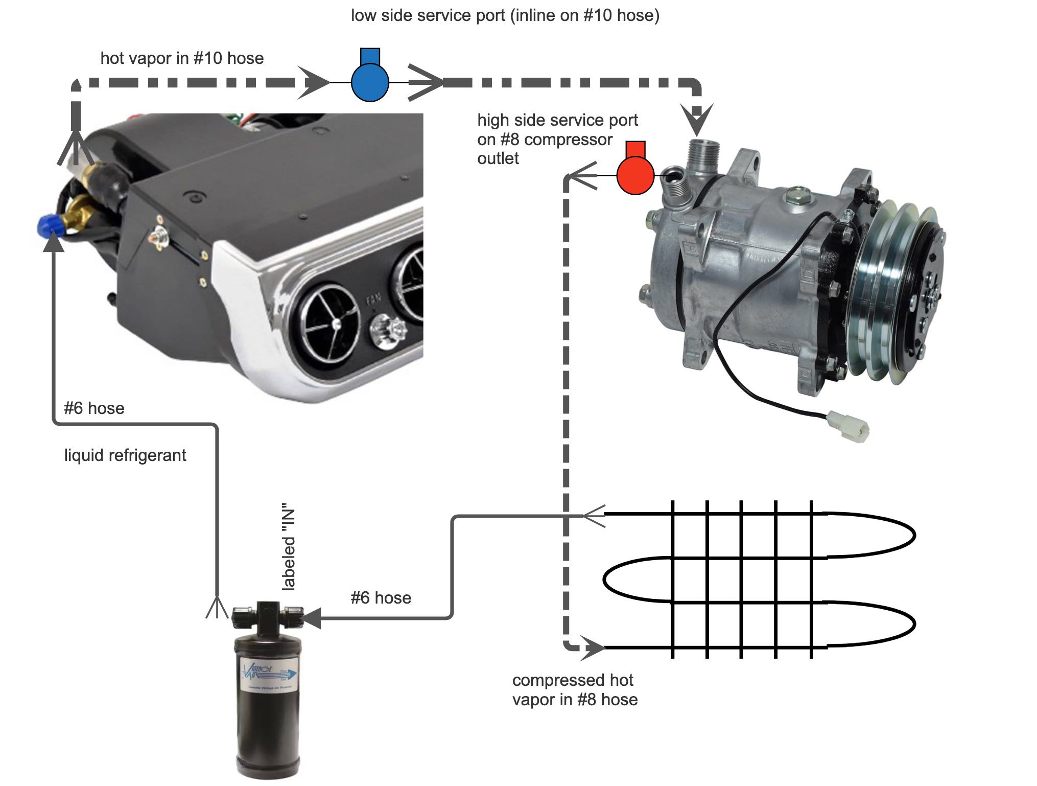

I am going to draw a map of my install to verify direction of flow. In the meantime, I checked the thumbwheels (both fully clockwise) and the hose orientation (knurled ends on the manifold).JohnHere wrote: Sat Jun 29, 2024 6:03 am Anything is possible with pressure readings of zero on the high side and 85 PSI on the low side. But let's start with the simple stuff.

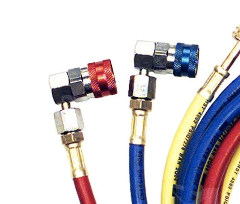

I am noticing one thing though... on the fitting end of the hoses, the fittings are tight against the hose ends. In the photos of the product (a Four Seasons 59199) the fittings show a small gap between the end of the fitting and the end of the hose.

I don't think that makes any difference. It's just the way the ferrules and fittings were installed and crimped at the factory.msrichmond wrote: Mon Jul 01, 2024 7:42 am I am noticing one thing though... on the fitting end of the hoses, the fittings are tight against the hose ends. In the photos of the product (a Four Seasons 59199) the fittings show a small gap between the end of the fitting and the end of the hose.

Re: new install charging problem
msrichmond wrote: Mon Jul 01, 2024 7:42 am I am going to draw a map of my install to verify direction of flow. In the meantime, I checked the thumbwheels (both fully clockwise) and the hose orientation (knurled ends on the manifold).
JohnHere wrote: Mon Jul 01, 2024 10:06 amGood idea on drawing the direction-of-flow map, especially because you're new at this.
- AC diagram.jpg (175.6 KiB) Viewed 14636 times

In your diagram, the condenser is inverted.
High-pressure refrigerant gas from the compressor enters at the TOP of the condenser, condenses, and travels to the outlet at the BOTTOM, exiting as a high-pressure liquid. The liquid refrigerant then flows from the bottom of the condenser to the R/D and on to the TXV, where it changes from a high-pressure liquid to a low-pressure liquid.
The low-pressure refrigerant gas (and sometimes a mixture of gas and liquid on systems having an OT and accumulator) exiting the evaporator is normally cool to cold.
