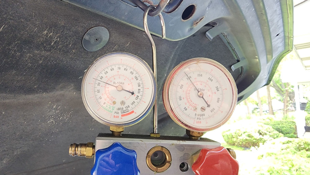

Ambient outdoor temp is 77 degrees and my pressures seem normal to me..... at 900 engine rpm, they are right around 35 low / 175-200 high. (depending if electric fans are on or not)

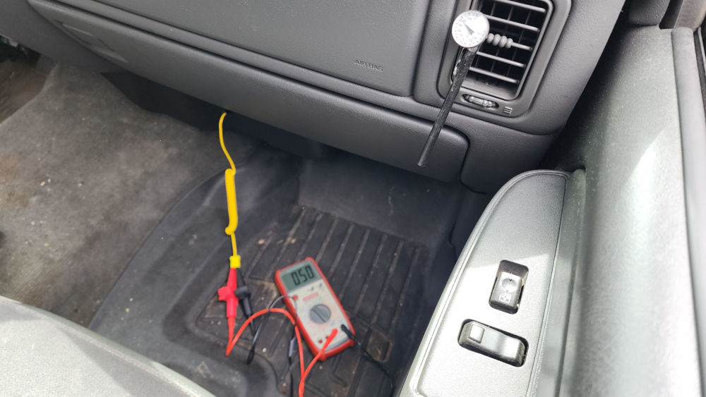

I even installed a temp probe in my HVAC box to see the temp of the evaporator. The prob goes into the box roughly 5 inches and the tip of the probe should be right in front of the evaporator on the discharge side. (where the cold air should be)

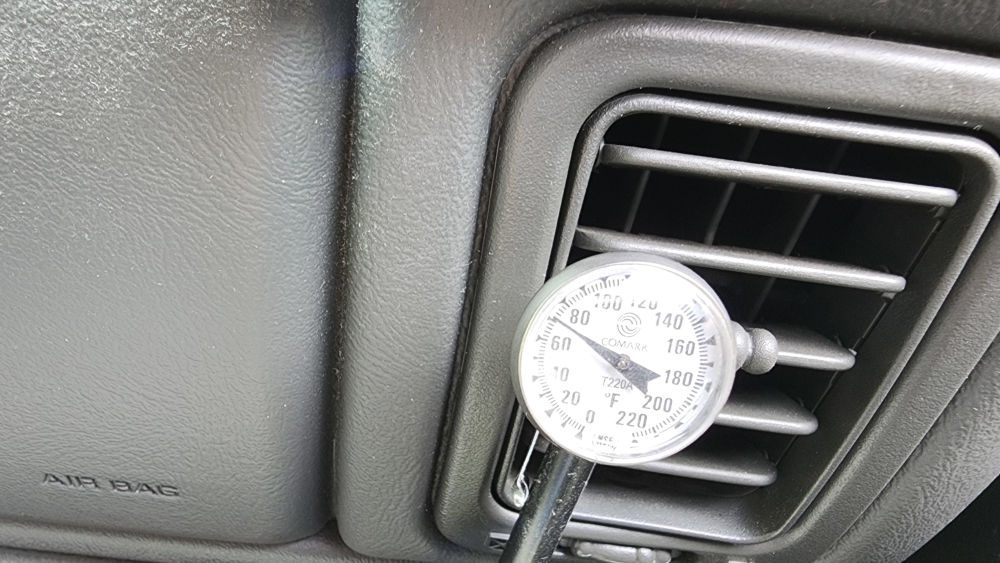

Why would my vent temps be between 50-60 degrees?
Shouldn't my evaporator be colder than 46-50 degrees?
60 degree vent temps are not acceptable on a 77 degree day, in the shade. lolol.

I am familiar with the water mist on condenser trick but I didn't try it because the high side pressure is where it needs to be.... plus, when the fans turn on, the high side pressure drops 25-30 psi almost instantly.
