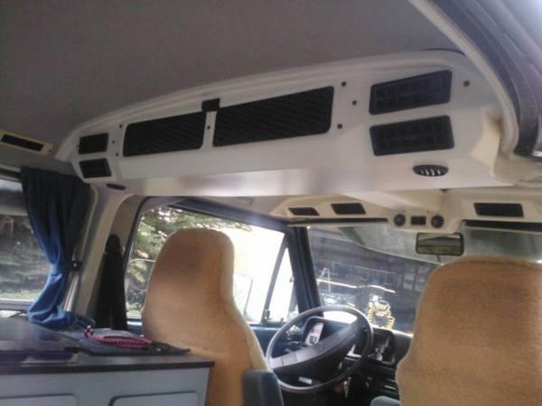

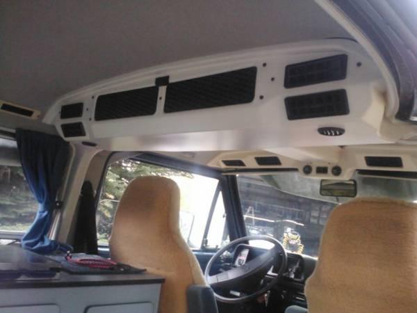

Let me offer more information. I’m planning to install air conditioning in a VW Westfalia that never had a/c. I’ve read the excellent thread posted by vanis, and the hummer install. I’m planning to use a modified version of this installation.
With modern equipment inside and out. The reason I ask about 12volt is two fold. As the unit is toward the front already it seems hoses could be much shorter if compressor was under the floor. The option of being able to cool while parked is nice but I do understand the power requirements. Primary goal is cooling while driving though. And load on an already under powered engine. I currently have a 120amp alternator, and 200 ah of house batteries which should be enough to power while driving! Really just want to know if the technology of these is reliable or would it be better to go tried and true. I’m sure I’ll have many other challenges with is project. I will continue to educate myself on what it will take to get this done and appreciate this forum.
