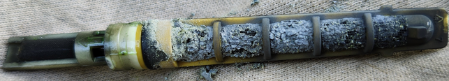

Finally got back to this car. Recovered and recharged to oem level. No help, still poor cooling. Pulled orifice and it looks like this. Not a good sign, this is going to be entire system as John described?

Yes, unfortunately. The comp grenaded and took out everything downstream as he described. Please remember that a condenser cannot be flushed

northbay wrote: Sat May 18, 2024 4:59 pm Finally got back to this car. Recovered and recharged to oem level. No help, still poor cooling. Pulled orifice and it looks like this. Not a good sign, this is going to be entire system as John described?
Based on the look of the OT, I'm not surprised that the cooling performance is poor. Little to no refrigerant is making it through to the evaporator.
If you'd like cool A/C in this car, you'll definitely need to do an overhaul, as tbirdtbird said. Service it properly, and it will cool properly. Might as well tackle it now before the heat of Summer arrives.
As for the components you'll need to replace, figure on a new (not rebuilt) compressor, new condenser, new accumulator, and a new orifice tube (yellow/white [.062" orifice] is the correct part).
IIRC, the 2005 Buick LeSabre didn't have mufflers or "cans" on any of the lines, so you should be able to flush the lines if they're otherwise in good condition. The evaporator can be flushed without removing it by attaching some clear plastic tubing to the inlet and outlet fitting at the firewall to inject the solvent and catch/inspect it as it comes out. Make sure that you thoroughly dry-out the components you've flushed by blowing through them with nitrogen (preferred) or clean, dry shop air. Of course, you'll need to put back in the entire amount of oil called for by the manufacturer's specifications, as well as the exact amount of refrigerant by weight.
The specifications that I have for your car (all engines) call for 38 ounces net weight of R-134a, and 9.0 fluid ounces of PAG-150. If you have an under-hood decal that differs, the decal takes precedence.
