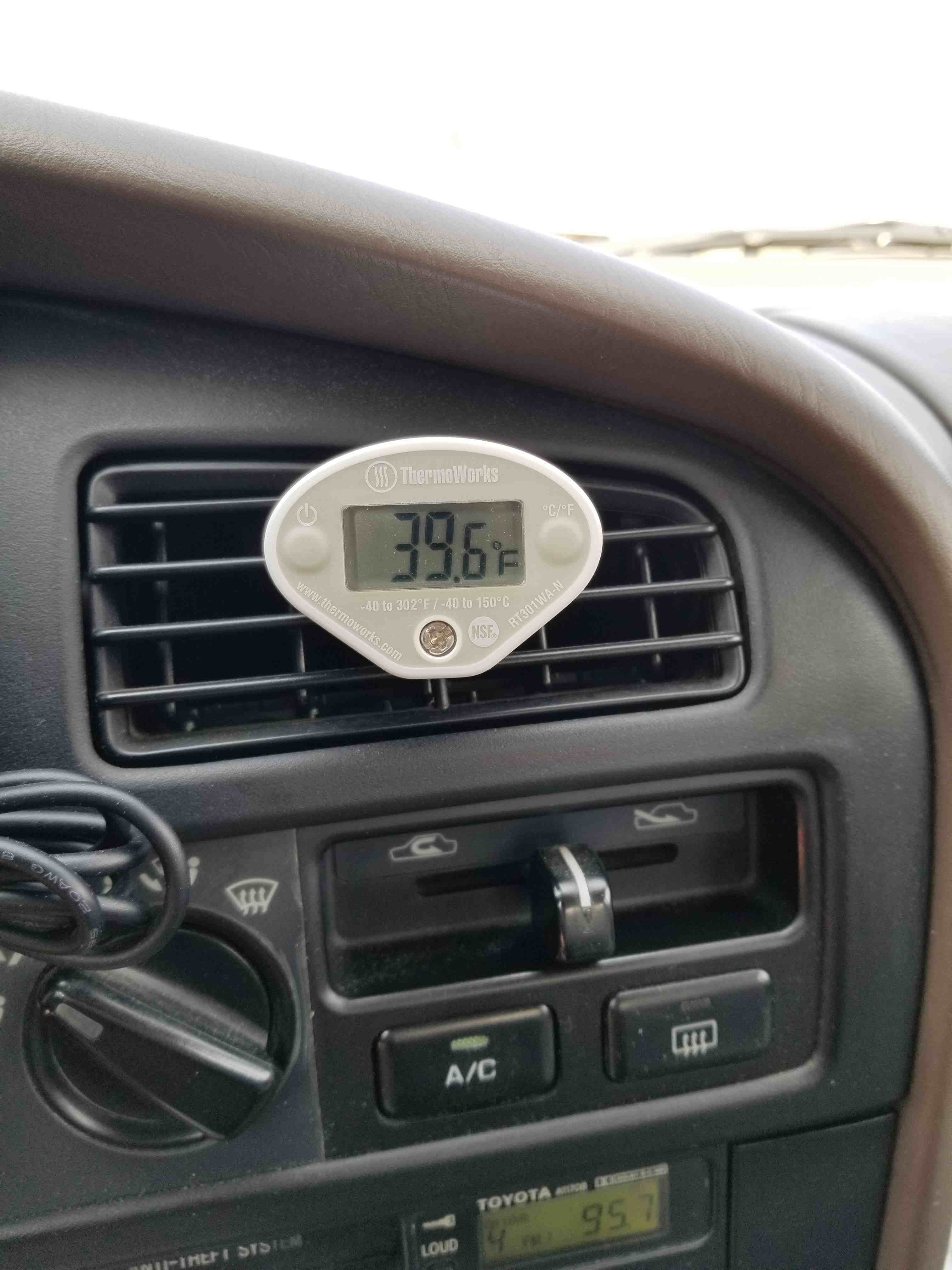

Re: Leave well enough alone or charge AC system? Older Hondas
Posted: Sat Apr 20, 2024 6:53 pm
Place a thermometer in the center vent and keep it there so that you can monitor A/C performance as you drive. Should temperatures rise into the uncomfortable range, you'll know immediately that you have a problem, verified by the thermometer.
