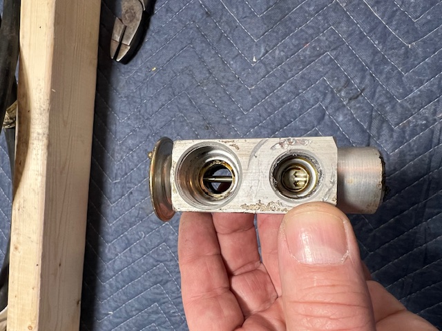

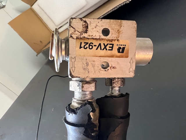

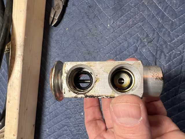

I never really thought about reusing it. I just thought if it could replace it with something new, I wouldn’t have to worry about putting it all back together and it not working, or not working right with 134a. Does the refrigerant matter to the exv? Do they go bad? Can they be cleaned or checked? Threads look a little boogered up in one port. Attached is a pic of the valve. I will gladly scan the Clardy docs and attach them if it would help someone.

From outward appearances, your original TXV looks pretty good. Hopefully, the internal sealed and charged portion is intact as well. The refrigerant doesn't "matter" to a TXV. I believe there is sophisticated equipment that not many people have to verify a TXV's operation. Best option for a home mechanic is to clean up what you have, install it, and see if it works.
As you probably know, Clardy is long out of business. For a system that old, it's somewhat of a guess that the original TXV will work. If it were mine, I would try reusing it. Regardless, if you want to replace it, a Four Seasons #38881 is reportedly a drop-in replacement. I'm not sure of its superheat spec, though. Contact Tim at ACKits.com, this Forum's sponsor, to see whether he can get one for you.
