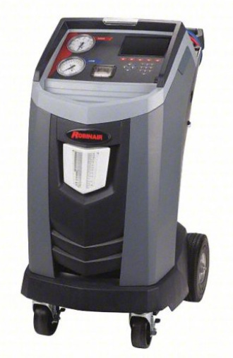

Depends on the reclaiming equipment. Big machines reclaim and clean the refrigerant. Some of the lower-end stuff reclaims the refrigerant.

Most dedicated AC repair shops have a sealer identifier, refrigerant identifier, and top-of-the-line R&R machine.
Step one: Check for sealer;
Step two: Check if it is a pure refrigerant.
Step 3: R&R machine for any refrigerant which passes steps 1 & 2. Which then can be used again. No reason to steal or waste a customer's refrigerant.
