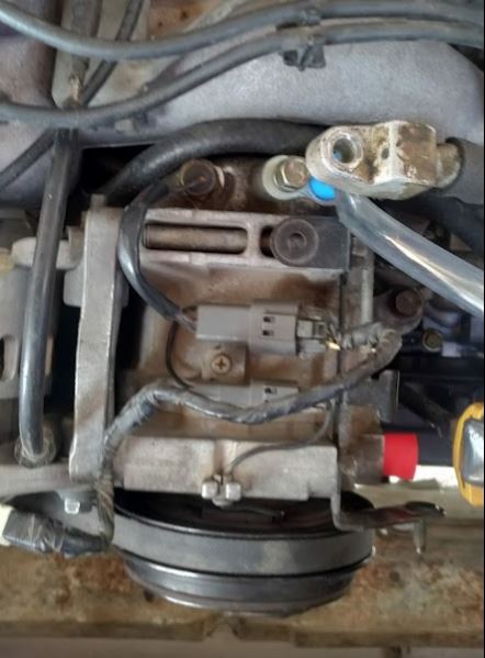

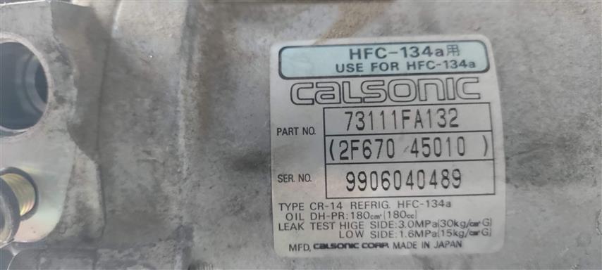

Hello, might anyone have the specs for a compressor:
Calsonic 73111FA132 It is from a 1999 Subaru Forester.
I have googled the part number without much success.
I'm wondering if it has enough volume for a 6-vent 35,000 Please don't spam our Site - Forum Rule #8.
(some sites have that unit at 32,000 BTU)
I saw another thread where there was a link for the 5-vent 22,000 BTU one at site sponsor Please don't spam our Site - Forum Rule #8. but I can't find the item searching their website.
The system will have a 16"x24" parallel flow condenser. It will be in a VW Vanagon.

As for your compressor, I could not find any information on displacement.
I would try and fit something like this.
14-2826NC
Re: Specs for Compressor - Calsonic 73111FA132
Posted: Fri Aug 25, 2023 10:37 pm
So this is a Subaru swapped Vanagon?
That compressor crosses with A Valeo 815641 or a 4S #68653 This is a direct mount compressor with 4 bolts and peanut fittings. I have no data on displacement, and can't even say if it is piston or scroll.
A SD7H15 Sanden has about as much displacement as you can find in a similar sized compressor. An adaptor plate could be fabricated.
The SD7H15 maxes out around 34,000 Btu/h @ 4000 rpm compressor speed. At 1500 rpm you will see about 14,000 btu/h. And it will take about 10 horsepower at full output. In reality at cruising rpm, plan on 23,000 to 27,000 btu/h output.

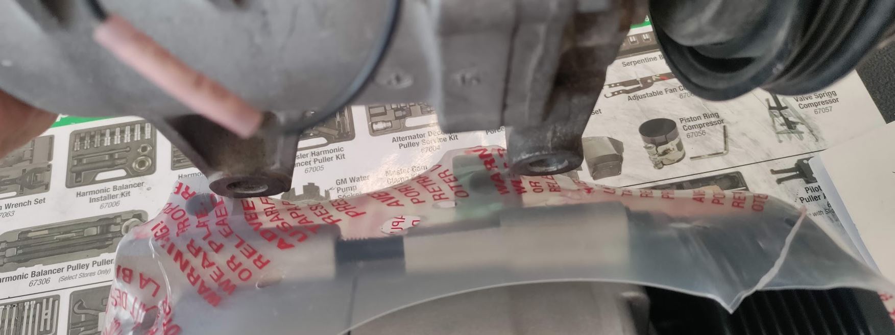

Thanks for the FS10 lead. There are several nice things about the FS10 for this substitution: (some pics below highlight these items)
1) Mounting looks like it will work with an easy to create adapter plate with holes - basically bolt plate to engine holes and then compressor to plate.
2) it is almost exactly the same length which allows it to fit considering the length restriction due to the intake manifold.
2.5) There are many configurations in comes in including connections on top which is necessary for clearance since no room in the back.
3) there are different pully versions available some of which align further in or out which may help with belt alignment

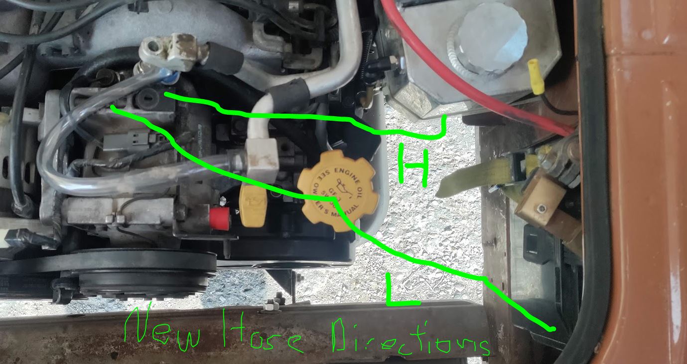

Showing placement and new hose directions to expected top-side connectors

Looks like you don't have a lot of axial space for the compressor
The site sponsor has (or can get) most anything in the A/C world. Maintaining a catalog that large is a daunting task. Here is the direct mount SD7h15, also available in a serpentine belt:
https://www.ackits.com/comp-flx7-4419-p ... 4-SD4419NC
The 4 rib belt can transmit enough power. You can just use the 4 ribs closest to the compressor body.
How much vertical height do you have above that existing compressor to work with?
