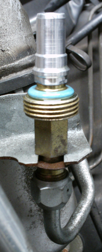

Finally, I have a mysterious item which seems to be a vestigial coupler of some sort, and has been weeping oil:
For reference, this item is teed into the line which feeds the accumulator; and is positioned at the end of a u-bent section of tubing that is filled with system oil. What exactly is this coupler, and can it be removed along with the u-bent section (and the contained oil) without ill effects?

The component in your photograph looks to be a low-side coupler and/or test port, but it's one that I'm not familiar with. Perhaps it's a European-spec-only testing and charging port for R-12. By its appearance, it looks like a metal dust cover would screw onto the threads. Did the car come with a dust cover in place? In any case, I would remove it and the metal line and just add a standard R-12 or R-134a test fitting (whichever refrigerant applies) directly into the tee.
