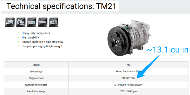

To start, the compressor for the rear is going to be a TM-21 compressor which has a displacement of 13 cu-in.

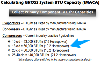

According to a Trans-Air PDF guide, a 13 cu-in compressor should be able to handle 60k BTU.

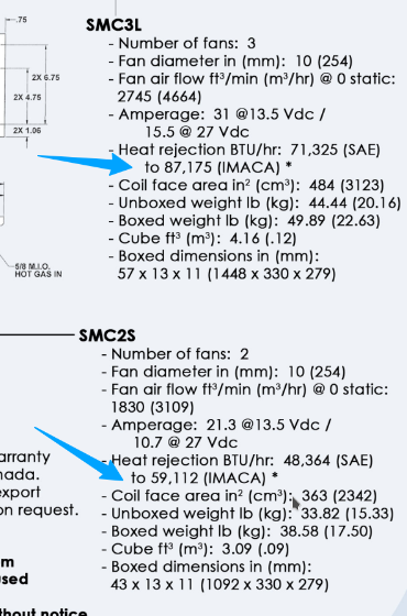

WIth that 60k compressor capacity in mind, for the condenser, I'm leaning towards the Trans-Air SMC2S which has a capacity of 59k BTU, although the SMC3L is an option (if I can fit it in the "skirt" area) and has a capacity of 87k BTU.
So this leads to my first question: with the compressor capacity and rating in mind (60k BTU), does it make sense to even pursuit trying to fit the larger capacity SMC3L (87k BTU) or should I just go with the smaller SMC2S (59k BTU) ? Price wise, the two units aren't too far apart so would the larger condenser unit allow the system to operate with less duty cycle on the condenser fans (and alternator load) ?

Well those are some pretty magical compressor numbers.
The TM-21 is a great compressor. But the manufacturer says it maxes out at 40,945 Btu /hr And it needs 12 horsepower to get there
http://www.valeocompressors.com/en/tm21
So you can scale your plans from there. The next thing you need to look at is drive ratios and engine speed. What sort of output will you really be getting under normal operating conditions based on the chart at the above link.

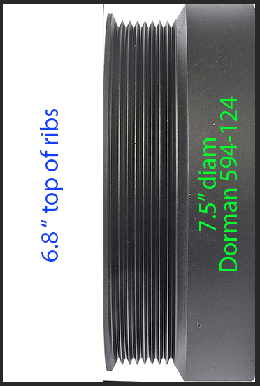

The engine (7.3 diesel) turns at about 2,250 - 2,400 RPM on the highway. I'll get the exact crank pulley diameter sometime this week but a quick measurement in PhotoShop based on a Dorman pulley for this engine says the crank pulley diameter is about 6.8 inches (top of the serpentine grooves) . The compressor's pulley is 5 inches (top of the serpentine grooves) so the drive ratio should be about 1.36 and the compressor at about 3,000 - 3,330 RPMs on the highway.

So 34,000 Btu's at cruise.
The condenser and evaporator just got smaller.
