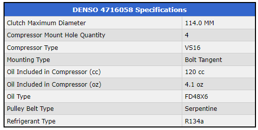

I have question about Denso 471-6058 A/C Compressor with Clutch, what kind of oil it has been used for that model and is there any idea because I didn’t get it what is this FD48X6, thanks
Denso 471-6058
Denso 471-6058

PAG oil is fine.

Thanks Tony. So, any PAG oil will be fine or there are a specific one.

Denso compressors using R-134a refrigerant normally take PAG-46 (ND-8) oil. If you can find double-end-capped PAG-46, so much the better.

Boss2000 wrote: Sat Jul 22, 2023 8:13 am Thanks Tony. So, any PAG oil will be fine or there are a specific one.
No!
To a degree, you can't even go by OE standards anymore. Most compressors on sites like the tag posted use import compressors. A Nippondenso 10pA15C and an import 10PA15c may use different PAG oils. You need to have a source that knows what product you're buying. In the example, would running Pag 46 be harmful? Probably not, but if the import was designed for Pag 100. It would be best to run the proper Pag oil.

Thanks all for your valuable information but still until now I didn’t get the answer because I already asked the company and then they sent me back what you see now FD48X6, I have asked them again what is this and are there any recommendations, until now I didn’t get the answer from them
