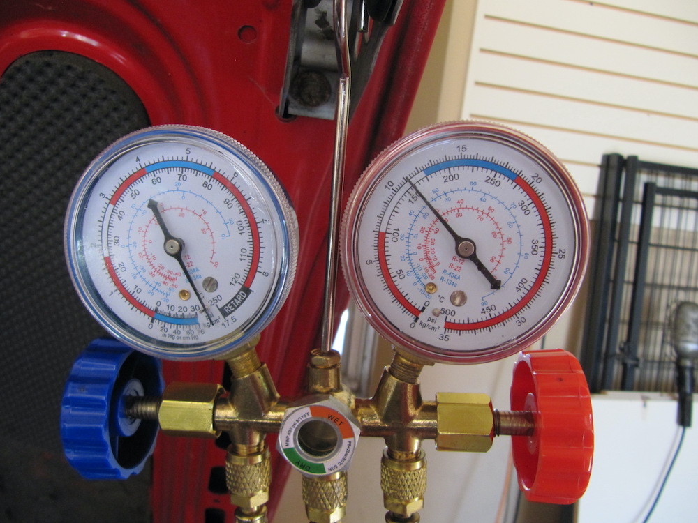

Here is a video of the gauges with the engine at idle and then revved up to maybe 1,500 rpm. And you can hear the compressor make some scary noise at the end.

And a picture with static pressures (system off) included. The low side is pegged!

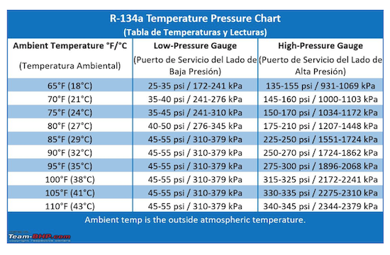

Also I have this schedule of pressures with temperatures. It is hotter than hell in Texas right now, so the chart is showing the high side at 315-325psi!!!

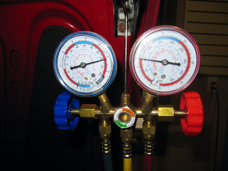

Another data point. It is 80 degrees F this morning. I hooked up the gauges to read the static pressures.
Low and high sides still equalized and each now at 100 psi.
I've understood that static pressures kinda follow F degrees, so I was expecting a little lower.
But when you figure I loaded in 10oz of R-134a when it calls for 28oz, it is a real head scratcher.
My port for the low side is on the return hose downstream of the evaporator to the compressor. The high side port is between the receiver/dryer and expansion valve.
Maybe time to tear it apart, again.
Static Pressure at 80F cold engine

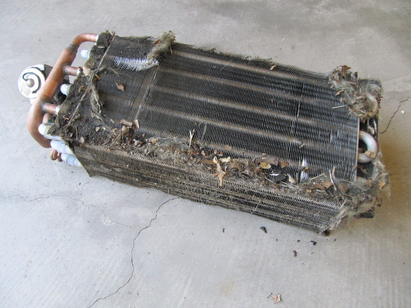

BTW, this is the old [edit] evaporator [/edit] and what came out of it.
