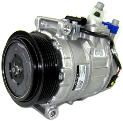

I believe this is the clutchless compressor, so I'm having some trouble telling if the compressor is ever cycling on. I know it should kick on maybe at 60 psi (??)...

Yes - I'm careful about not letting air IN to the system. I'm guessing then - from your last post - that my compressor is not running. On a regular, clutched compressor, I can easily see the clutch engaging, but on this clutchless compressor (Denso 471-1474), I'm not sure what's going on.
It sounds like I am getting some in, but then - as you stated - the pressures are equalizing because the compressor is not cycling on.
Is there a way to test this?
I know jumping the compressor to ON is generally not a good idea - any suggestions?

Looking up the Denso 471-1474 compressor for a 2003 M-B C240, which ostensibly is the correct OEM compressor for your car, the description and specifications from Denso say that it has a clutch. Going by its outward appearance, it also looks to be a variable-displacement compressor having an electronic control valve.
Are you sure that the compressor you have is clutch-less?
Presuming the above compressor actually is the one you have, and the clutch isn't engaging, the problem could be as simple as the clutch air gap being too wide. From the new compressor photos, it appears that you won't be able to slip a feeler gauge between the clutch "drive" and "driven" plates to measure the gap. Alternatively, try (very carefully) nudging the center of the clutch with a piece of wood, like a two-foot-long two-by-two. You'll need to have the engine running and the A/C system turned on for this test. Again, use extreme care when doing this, avoiding any other rotating parts. If the clutch suddenly engages by nudging it, you'll know that the gap is too wide. The fix is either disassemble the clutch and remove a shim, or replace the clutch assembly with a new one.
If the clutch doesn't engage after nudging the center plate, then you might have deeper problems with a bad relay, open wiring, or faulty clutch windings.
You might also have a clutch that's actually engaged, but the compressor is running at virtually zero displacement and pressure due to a faulty control valve.
Lastly, connect a scan tool to the car (or have it done) to determine whether any stored trouble codes appear, specifically for the A/C system.

No Clutch Coil.
