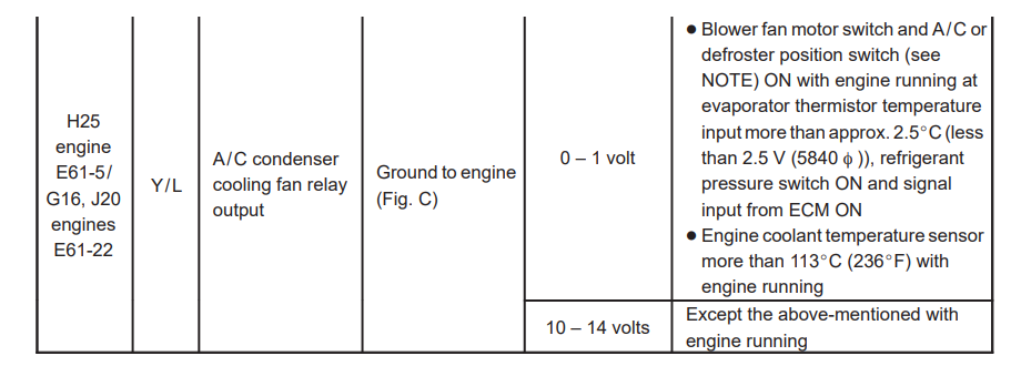

What i found in service manual, I update as photo in attachments.
there are two conditions listed there to Fan: one for the A/C system, the other for the coolant temperature...do they have to be two at a time or one?
wentylator suzuki.png (59.95 KiB) Viewed 2032 times

The ambient temperature in your area is too low. I recommend waiting until the daily temperature rises to 80°F (27°C) or above. Then, re-test the system.
