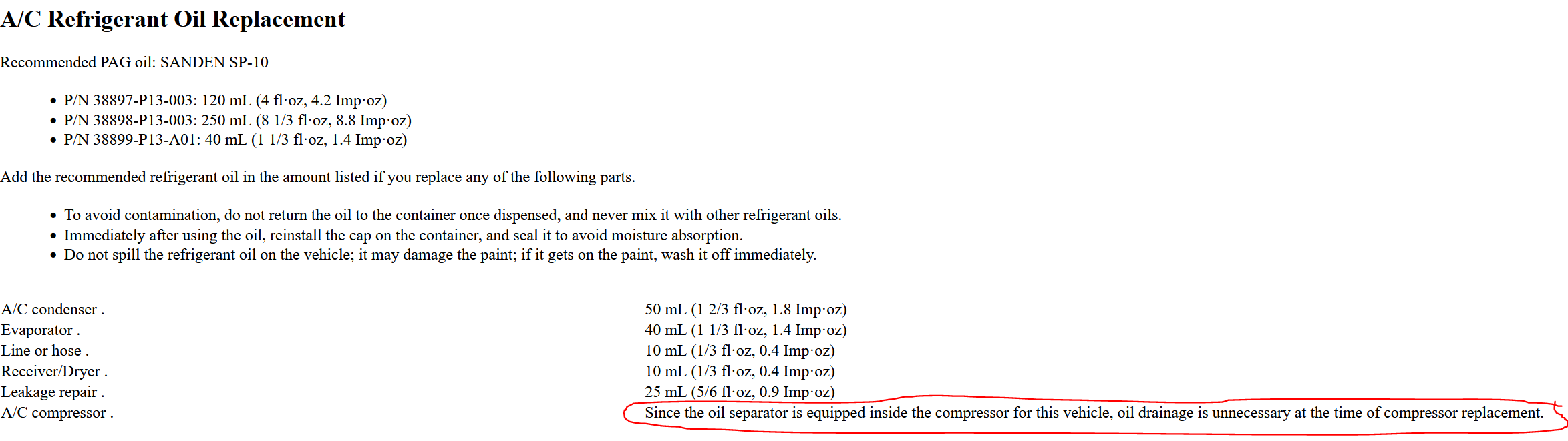

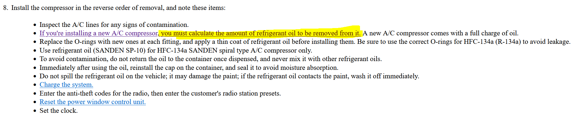

The service manual contradicts itself here on compressor replacement oil:
I'm going to replace the compressor and receiver drier soon. What oil replacement procedure would you recommend following for this specific car? I'm likely down on an unknown amount of oil from this leak.

I would empty the oil out of the old compressor being sure to turn the shaft by hand to get all the oil out, Drain it into a paint cup or similar that has graduations so that you can measure how much you got out. Once the R/D has been removed, also dump the oil from that and measure.
Dump out all the oil in the new comp again being sure to turn the shaft to get it all out. Put back in the amount you got out of the old comp.
You should have some new oil leftover from the new comp at this point, use that to put back into the R/D what you drained out. And Then add one more oz to the comp to compensate for the unknown amount that was lost.
Unless you totally flush out a system, (which is very hard to do), and start with a new comp with the known OEM amount of oil which will ultimately distribute itself throughout the system, you really have no way of knowing exactly how much oil is in the system. But it doesn't matter. The approximation process works amazingly well,
Be sure to turn the shaft on the new comp about 12 times to distribute the oil you put back internally
