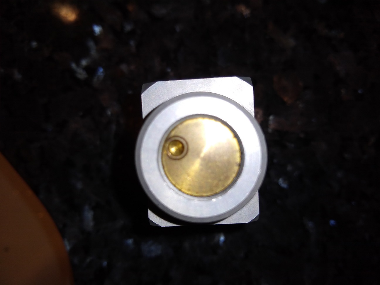

I have noticed a brass disc or plug on the bottom of the valve, but it only has one small hole, and it is perfectly round, not made for an allen key. And only one hole! If it had been 2 holes, like I see on some of the valves at the Egelhof site, I would have already fiddled with it.
Here is a pic of the end of Egelhof valve. I am tempted to drill a second small hole in the brass plug. It does seem the plug is threaded into the body.
With 2 holes I know I can turn it. I have an old valve and I can play with it.
Ideas?
