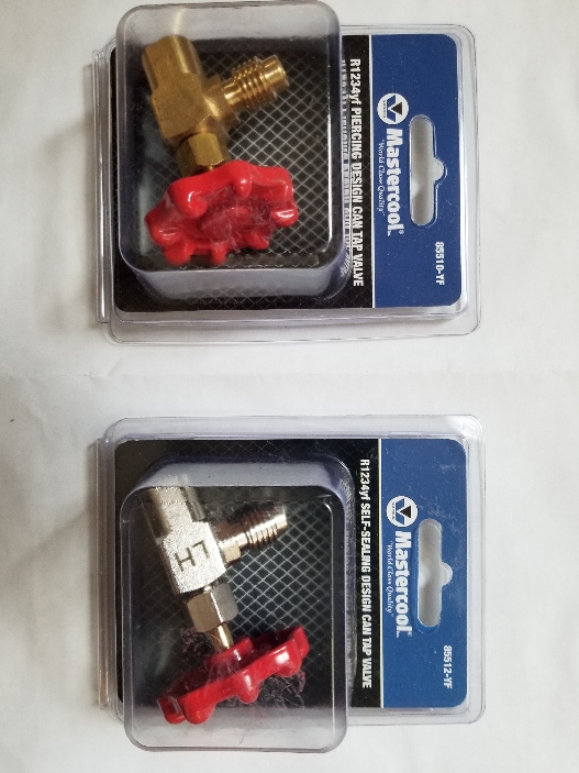

I bought a r1234yf can tapper and the threads are 1/4" sae threads. Of course that didnt fit.......this has been so frustrating and confusing getting information. I need to buy another r1234yf can tapper now that has 1/2" acme thread.
I did notice a small valve at the end of the yellow charge hose....well....thats one less thing i have to worry about.

Hmmm...I wonder whether the package was mislabeled or something.acnoob wrote: Fri Aug 12, 2022 11:28 am I bought a r1234yf can tapper and the threads are 1/4" sae threads. Of course that didnt fit.......this has been so frustrating and confusing getting information. I need to buy another r1234yf can tapper now that has 1/2" acme thread.
When looking for another one, be sure of which design you want: Piercing type or self-sealing can. I'm sure that Tim can get you either one.

My yellow charge hose is a 1/2” threading.JohnHere wrote: Fri Aug 12, 2022 2:59 pmHmmm...I wonder whether the package was mislabeled or something.acnoob wrote: Fri Aug 12, 2022 11:28 am I bought a r1234yf can tapper and the threads are 1/4" sae threads. Of course that didnt fit.......this has been so frustrating and confusing getting information. I need to buy another r1234yf can tapper now that has 1/2" acme thread.
