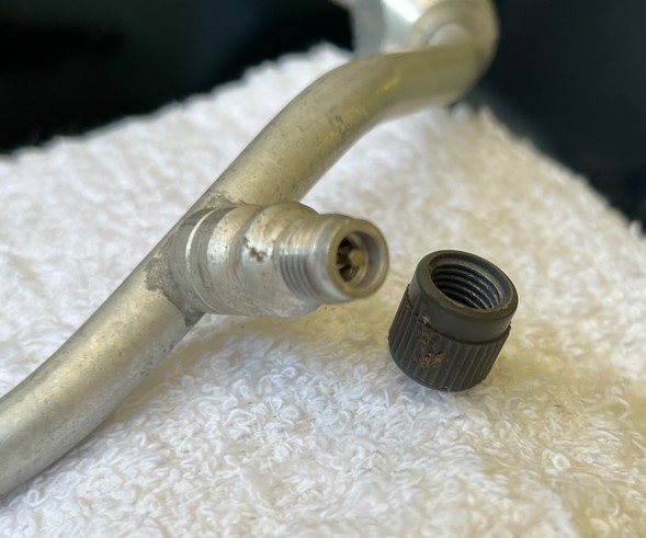

Doh! Helps if you remove the shrader valve before installing the adapter! Well, Low side is 1/4" flared and the adapter I bought (description below) fits fine. The high pressure service port, however, is smaller than 1/4" and is not flared. Thoughts?

Both 1/4" Flare adapters (the same thread size as 7/16"x20) should fit unless the 1/4" Flare fitting is missing from your HP line. In that case, what you're probably seeing are 1/8" NPT (National Pipe Threads), either female or male. The missing 1/4" Flare fitting should look something like this:Bill Reid wrote: Sun Aug 07, 2022 6:23 am Doh! Helps if you remove the shrader valve before installing the adapter! Well, Low side is 1/4" flared and the adapter I bought (description below) fits fine. The high pressure service port, however, is smaller than 1/4" and is not flared. Thoughts?

Nothing is missing on the HP side. In fact it has a plastic screw on cap. It is definitely not 1/8" NPT male. It is not flared, has threads smaller than 1/4" SAE (7/16X20UNF), and also has a shrader valve.
- HPside.jpg (55.11 KiB) Viewed 11202 times
Re: 86 S10 LS Swap - A/C info needed
That looks to be a 3/16 male flare.

It is not flare... at least how I understand flare. Unless the bore is flared? Is that what you are referring to? Happy to take more pics. The top of the fitting is flat. I have a 3/16" to 16mm R134a adapter on order. When I get it I'll share. I gather this is a unique setup(?).

That's nothing like any R-12 test port I've ever seen. It looks like a miniature 1/2" ACME. Was a pressure switch originally screwed onto that fitting perhaps?
