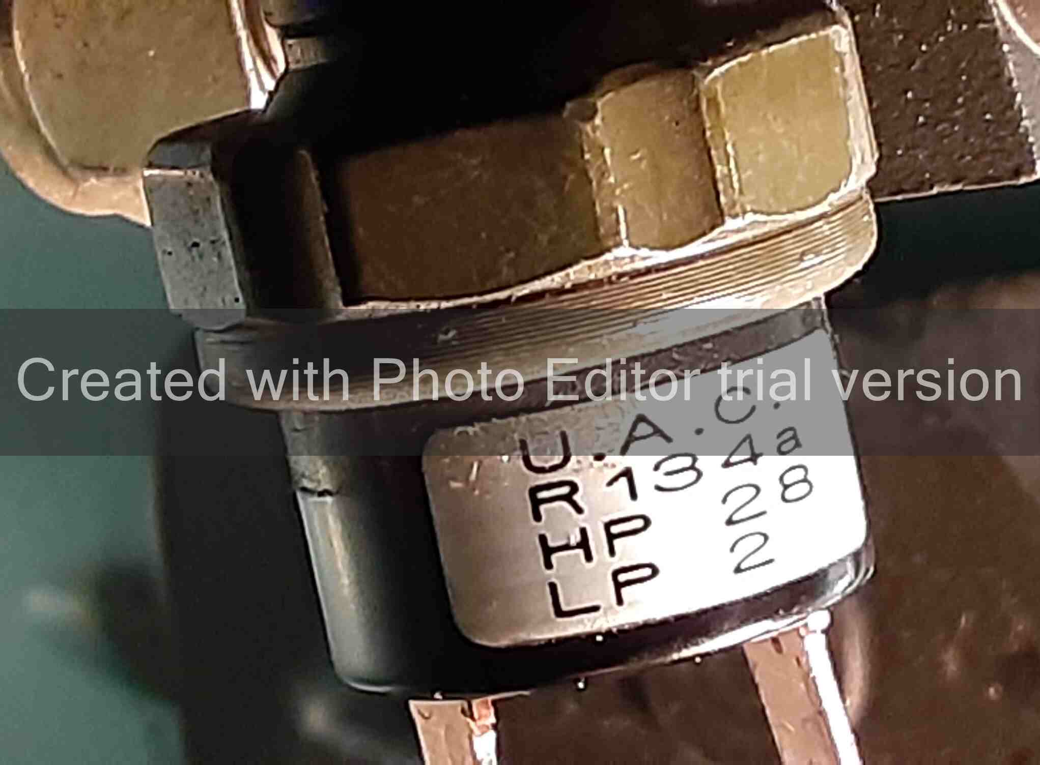

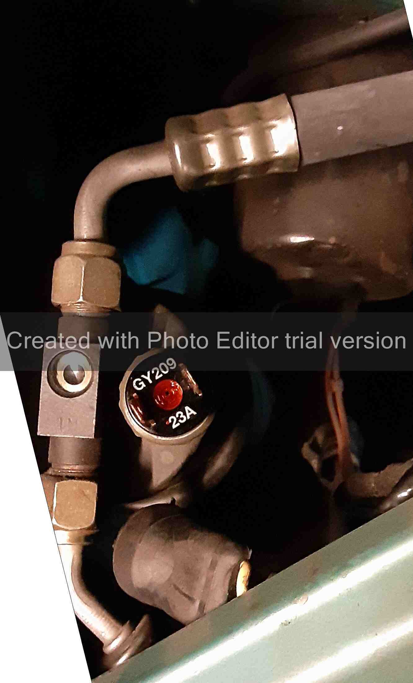

Parker filter w/ U.A.C. GY209 press switch (see images)

aribert wrote: Tue Jul 19, 2022 8:22 am I am guessing the switch has both a high and low limit based on the numbers.
That's correct. It's called a binary switch.

Rather than searching for a new switch, which it might not need, first ensure that you have the correct charge in the system. I suspect that it's just low on refrigerant due to a leak. With a car this old, it has a sight glass (S/G) on the Parker receiver/dryer. Add some R-12 to the low side via an R-12 Manifold Gauge Set until the compressor engages and you start to see some bubbles and/or foam in the S/G. Then proceed to "sniff" the system with an electronic refrigerant detector to find the leak(s).

Looking at the switch - are the numbers on the side of the switch (2,28) the pressure set points of the switch? If so, what units, since PSI does not make any sense to me (I would expect the high limit of the switch to be greater than 28 psi).
