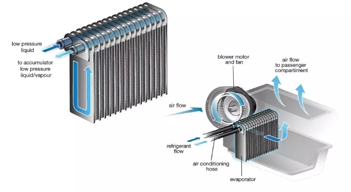

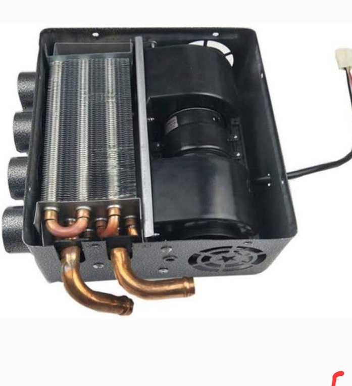

I was looking at some under dash evaporators pictures and the tubing goes horizontal side to side and like a Toyota evap has a main and travels down and up
If you place the under dash on its side it may be the same principal but not too sure if will work

Pkimr is this a theoretical question about all evaporators or are you asking about a particular one?
Those copper tube type will work in any orientation, best to keep the last run of tubing straight up or horizontal, it would work straight down, but in that case I'd run a higher superheat to make sure liquid isn't running out.
That second pictured type we call a plate-plate 2 tank. Run horizontal as shown, some tilt from horizontal in either axis is OK and happens due to g forces in corners, braking deceleration, acceleration
