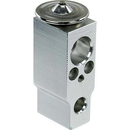

*ps* i suspected the expansion valve so changed it. that obviously was a mistake
