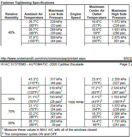

Posted: Mon Jun 13, 2022 7:26 pm
Re: Pressures.
Posted: Mon Jun 13, 2022 8:37 pm
Interesting. That chart supports my feeling that 3.0 x ambient is a maximum pressure.
Which vehicle is that?
Re: Pressures.
Posted: Tue Jun 14, 2022 7:31 am
20 Escalade
I just found this going through old files on my systems. The main point in me starting this thread is there is no magic pressure reading to achieve. We can't always say your high is too high at 210psi. When we do not know the variables, we could lead someone to try and achieve an impossible number. That is not to say bad advice has been given!
