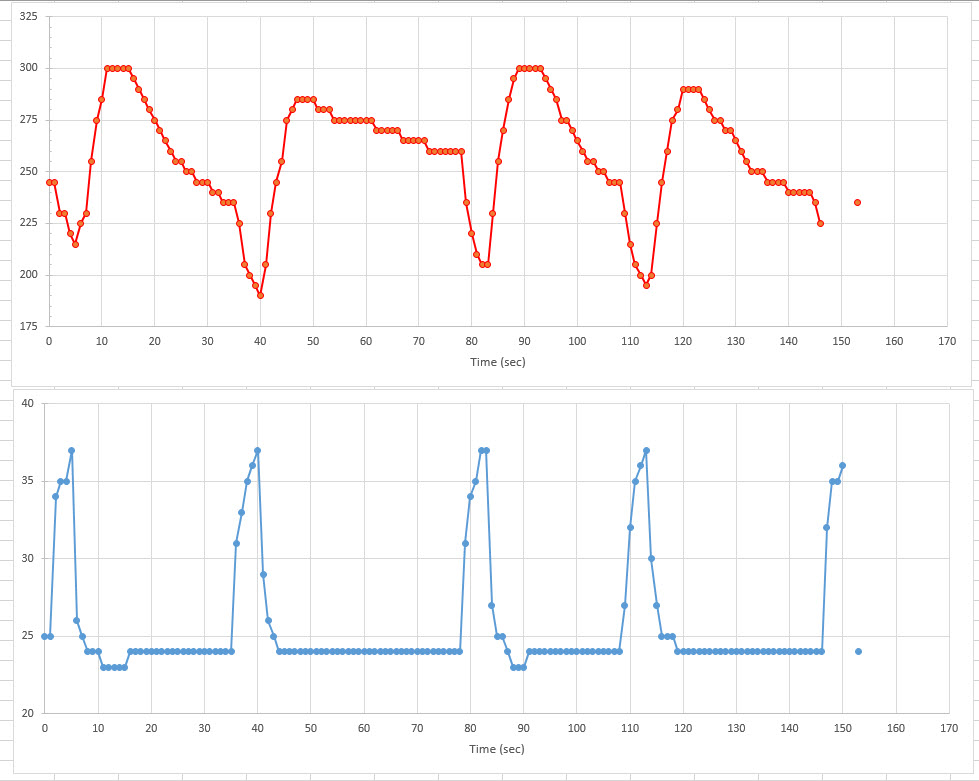

I am having trouble determining what is wrong with AC on my 2014 Nissan Pathfinder. These are notes detailing the problems and findings:
1. Vents blow warm when vehicle is not moving, and gets cooler when after about one minute movement.
2. AC compressor and fans cycle approximately every 30 seconds.
3. The attachment shows low and high side pressures over three minutes. The beginning of the low side spike is when the compressor turns off. The peak of the spike is when the compressor turns on.
4. Ambient was approximately 80F during testing.
5. Compressor discharge is hot.
6. Condenser outlet is ambient temperature.
7. Compressor suction is slightly cool, but not cold. No condensation on suction line.
Pathfinder AC pressures.jpg (110.03 KiB) Viewed 15630 times
Thanks for any help you can provide.

These are the last steps I took after talking to the people on the forum:
1. Vacuumed the system to around 29 in Hg for 30 minutes.
2. Charged the system with r134a cans to the weight listed on the Nissan Label. The cans do not have sealer.
3. Pressures were 30 psi low and 275 psi high.
4. Ambient temperature was 91 degrees.
5. Temperature from center vent was 92 degrees.
