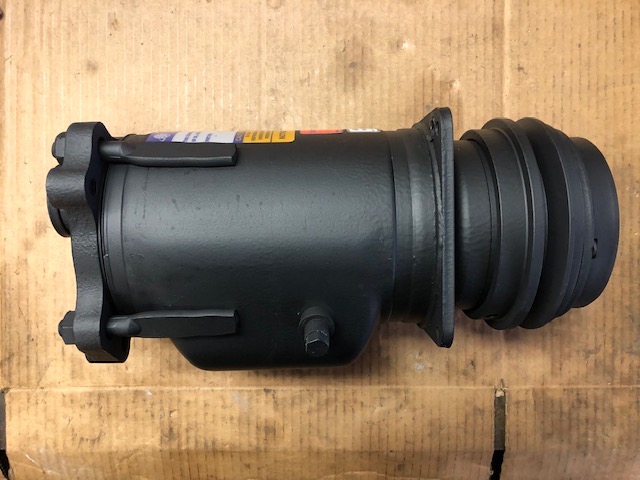

I’ve just purchased a new type GM A6 ac compressor, manufactured by company Alma Products.
Compressor is all correct, but it’s unfortunately filled with PAG 150 oil, not mineral oil.
I need a compressor filled with type 525 mineral oil, due to using R12 Freon in the AC system.
Can I simply drain and flush the PAG oil from the compressor, and refill with 525 mineral oil?
Or are there O rings and rubber seals etc inside compressor that will be affected?
Should I rather return the compressor?
Would there perhaps be a procedure available for this oil change and purpose?

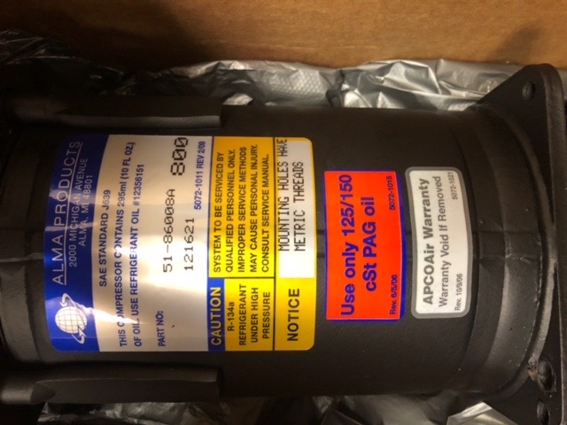

Compressor picture with label.
Re: New A6 Compressor received with wrong oil type
Posted: Wed Apr 20, 2022 7:23 pm
Had no idea that anyone was making new A6 comps.
Given the warning on the label, I would most definitely call the company and ask them your question. Usually the oil type is dependent on the type of freon, but that label makes you wonder in this case.
It is possible they have a model that is suitable for mineral oil, if this one is not.
If they say it is OK to switch oils, just drain out the old, (measure it) and rotate shaft about a dozen times, and refill with mineral (same amount) and rotate shaft another 12 times.

Maybe 15 years ago I bought a Sanden SD708 AC compressor from the board sponsor for my 1988 Mazda truck which was R-12. I was working at the R&D lab, so took in a drop of its oil to identify using a technique we had there, took 5 minutes (called FTIR, infrared spectroscopy). It turned out that the new compressor was filled with PAG oil. So I drained the new compressor, added some R-12 mineral oil and turned the drive plate by hand like a dozen turns, then drained that. Then I did that again. Then I added R-12 mineral oil to make what I felt was full charge for the truck, rotated the drive plate again. Worked fine for me.
Funny thing: a co-worker in my department had a 1990 Mazda Protege with R-12, and he got a compressor for his car from the board sponsor, same brand. His new compressor contained R-12 mineral oil. Go figure.
So my own personal experience is that the PAG oil in a compressor can be drained and flushed out using R-12 mineral oil. Do NOT use solvents to "clean out" a compressor !!!!

As suggested, drain-out the PAG that's in there now and flush it out a few times with mineral oil, then fill it with mineral oil one last time to specs. That'll save you the cost of the back-and-forth shipping of a rather heavy product. Don't use any kind of solvent to flush it out as stressed earlier.
