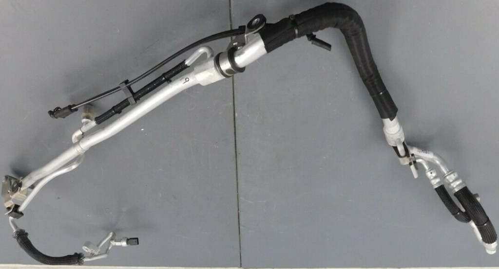

Can anyone tell me whats going on with this line? Its named A/C Suction and Liquid Line 68282106AE.
It looks like this part is two lines that merge together and then later split, or two separate lines that are bundled together in the middle.
I want to reroute it, but almost no shop will even touch it, and the one that would wanted $1,000+. I'm thinking if I want to make this happen Ill need to have the dealer drain/fill the R-1234YF and do it myself.
Any thoughts on this? If it is two completely separate lines, maybe using two stainless steel braided PTFE hoses and a high side port fitting?

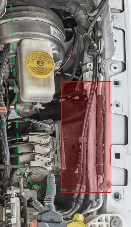

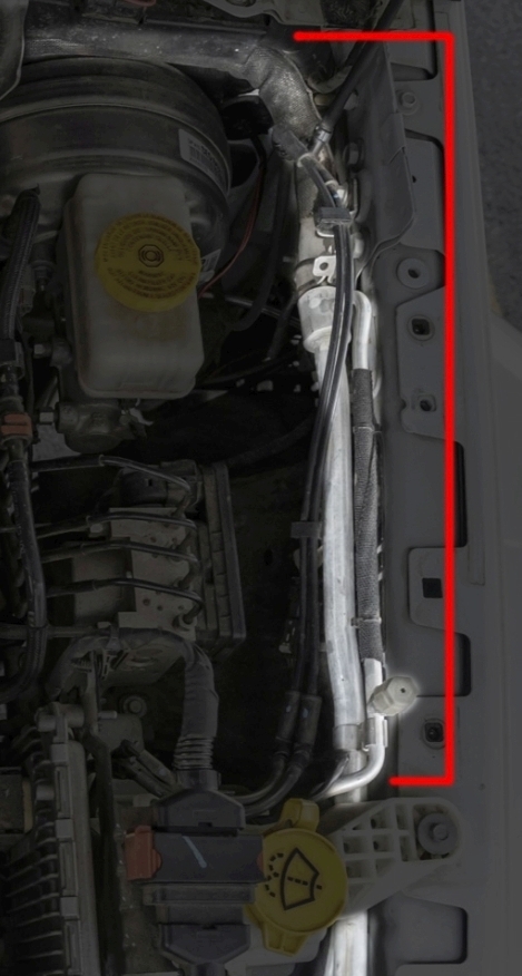

Heres another pic of it in the Jeep

According to the description of this part number, it looks to be a complicated assembly of the suction and liquid lines bundled together with some sort of wiring (liquid line cooler).
As installed in the vehicle, the assembly appears to be routed out of the way alongside the left inner fender. So I can't help but wonder why you're considering fabricating very expensive custom hoses to reroute the original lines--if that is even possible given the several tight bends of the pictured OEM metal lines.

It's an internal heat exchanger assembly, this is pretty standard for all light cars and trucks these days. It yields a slight performance gain.
Why do you want to eliminate it? It's in the way of some aftermarket mods?
Yes, you can eliminate it and just run a direct suction hose and a direct liquid line to the TXV. Probably goes without saying, but I'll say anyway, you will have to make ports in the new lines for sensors, service ports, etc. or possibly keep those sections of your donor OEM lines.

We used to call that a recuperator. It recovers a little suction line energy to further cool the liquid line.
In the case of automotive manufacturers it also recovers a huge chunk of your cash when one of the many brazed joints fails...

I also did not realize there are wires/sensors incorporated into this. I can assemble hoses, metal lines, fittings but hard pass on altering finicky electronics. Apparently Ive finally been talked out of this project :lol:

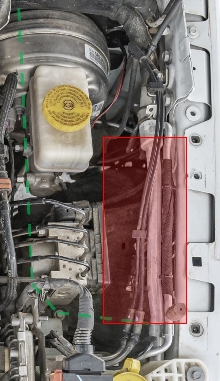

I wanted to re-route the lines to the path of the green dashed line in the pics to open up the space where the red box is. I want to put a filter train for an engine driven air compressor there, and the AC line is in the way by about 0.5 inch. I have yet to find a better spot for the filters (and I dont want them inside).
The custom lines (aside from the high side port) would have been made with leftover parts so there would have been little additional cost aside from the drain/fill. Parts are from a complex pneumatic system I put together, plumbed with -8AN (1/2 JIC) braided PTFE hose.
New path & open space
